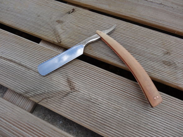

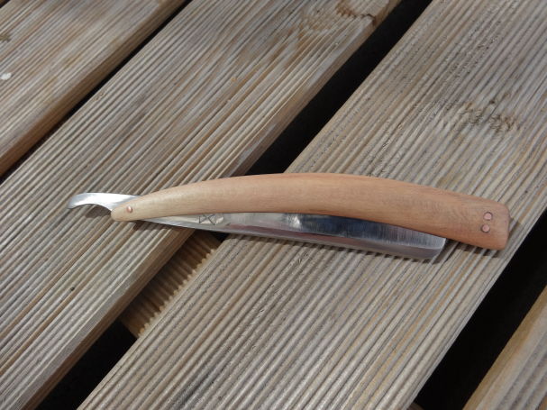

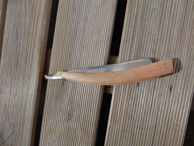

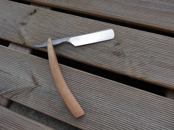

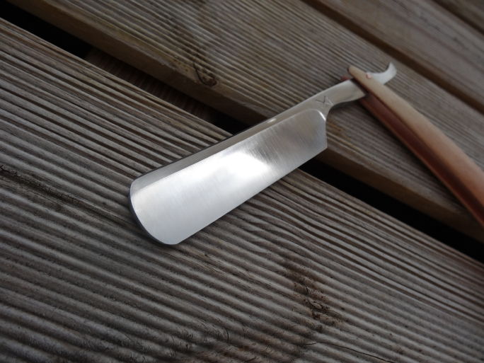

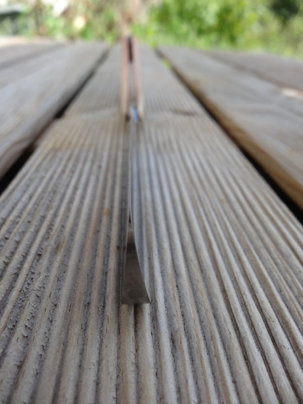

A real wedge
115w8, oil hardened (810°c keeped during 10mn , 2* tempered to170°c. Chasse Pear tree wood for the handle. That is a tree that was in my garden before the house build.
Ilt's really long to the sharpening, but the result is not bad at all. The shaving is not perfectly smooth now, i have some leather work to do
. The after shave heated a bit the skin, but the BBS was obtain in two stroke easily
