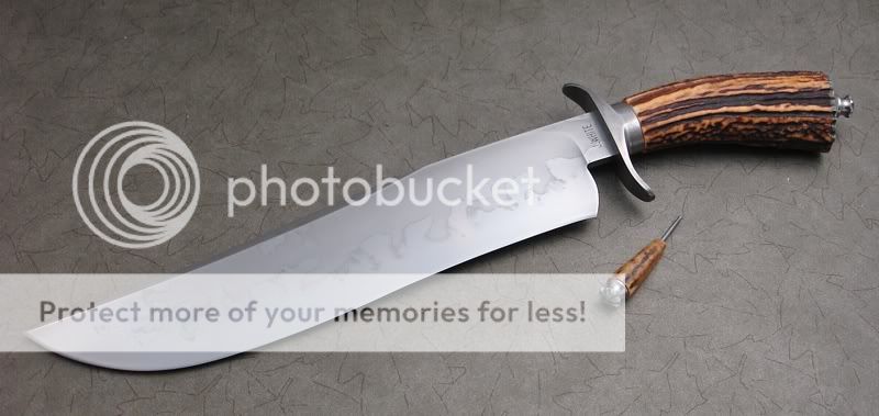

This one's leaving tomorrow for "Pappy" Long's and a beautiful sheath. Then it's off to that " green and pleasant land" across the water.
I'll add a pic of Paul's sheath work when it comes back from Texas.
This puppy's got an 11 3/8 inch x 2 1/8 inch blade. It's .235" at the ricasso, with a full distal taper, and it's light and fast in the hand.
The "S" guard, collar, and domed, fit-to-stag butt-cap are anchor chain wrought iron. The accent spacers and fluted finial are stainless, as is the fluted cap on the Take-down tool.
The curved tang was cast to the Sambar Stag handle with marine epoxy, so it draws up solid, and is chopper strong.
The stag, D-2 and stainless take-down tool holds spare assembly pins.

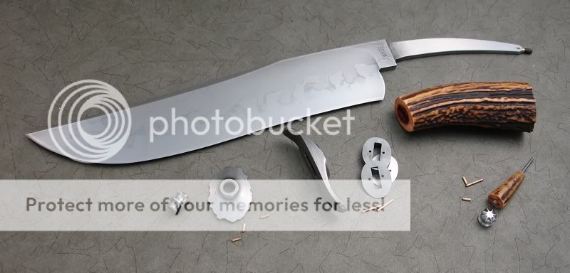

Here it is forged-to-shape..
Here it is finished out..
And taken down..
A final look for now..
Hope you like this one, now it's back to the shop to finish out that Persian I'm working on ,
