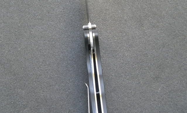

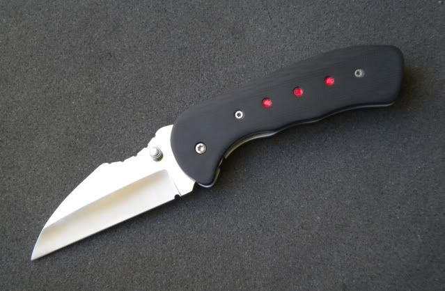

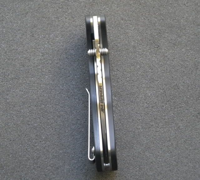

Finished this one up for a customer. One of my larger folders, this thing is built like a tank; the ti liners help keep the balance point at the index finger. The red Swarovski crystals are inset below the handle surface and shine like only Swarovski crystals can- the pics don't do them justice! This one has a very positive detent when closed, but still opens with no wrist movement.
SPECS:
  • 3.5" blade, 8.5" overall
  • .125" thick 154CM blade; HT by Paul Bos @ 59-61rc
  • .063" thick Titanium liners/ lock with Black G-10 scales; inset w/ 3 5mm "Siam" Swarovski crystals on obverse side
  • Stainless steel low ride pocket clip
Thanks for looking!
Bad ass man. Question though, what does this mean: "This one has a very positive detent when closed, but still opens with no wrist movement."
Thanks for the compliments! To answer your question, GrizzlyBear, It means that the blade is not likely to open accidentally, but a little pressure on the thumbstud and the blade pops right out. You can feel it "click" into place when you close it- I think the detent divot in the blade on this one is just a little deeper than I usually make it, but it seems to work just fine. It's probably a nice idea for anyone wanting a little extra peace of mind!
