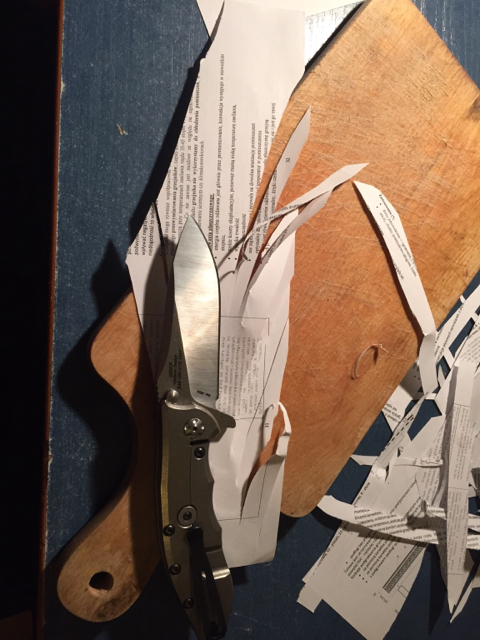

Now on to the rope cutting test. As an introduction I have to mention that this rope does visible damage (spots reflecting strong light) to the cutting edge after the first 10 cuts in every steel I tried (M2, CTS-204P, CPM-M4) so it's not your run of the mill natural fiber rope. I conducted the test in batches of 50 cuts after which I tested the sharpness by cutting paper a couple dozen times times to garner an average cutting proficiency. I know it's no scientific measure but it served me right and reliably up till now. The results I got are as follows: after the first fifty cuts the sharpness was still viable. It popped an occasional hair off the forearm and cut paper with rare hiccups.
The next fifty got me to a stage where the hiccups were prevalent but still the overall cutting was reasonably smooth. Of course shaving anything was out of the question.
After this stage I didn't notice more dulling, so at 150 and 200 cuts the knife still performed similarly.
Other knives I tried were the CPM-M4 CF Stryker. This was a big surprise as after the first 50 cuts it performed much worse than the Hills after a 100 and still a bit worse than the Reate at 200.
That made me abandon it and get to another knife. Next was a kitchen knife, probably made from Zapp's US2000MC which gave up after 80 cuts. I also tried the 0562CF CTS-204P (carpenters take on M390) ZT. After a 100 cuts it performed about as well as the hills at 50, unfortunately I didn't have enough rope to test it to the full, just did 50 more cuts.

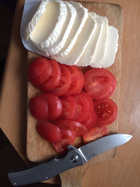

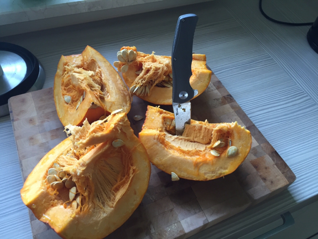

As for normal performance - I used the knife as my only EDC for a month now, also at work where I had to cut up quite a bit of cardboard and remove cling wrap from dirty and dusty pallets which means cutting on sandy wood, hitting nails every now and then and other pleasantries
. Apart from right after the rope test I didn't need to sharpen the knife. Of course the edge got flattened in spots where it must have hit a grain of sand or something, but overall the knife retains it's edge really well. I didn't get to test corrosion resistance as I babied the knife a bit ^^, but I wouldn't expect any surprises from my experience with S35VN.

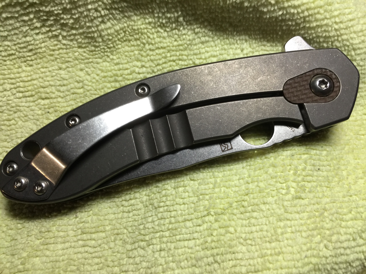

Let's start from the bottom - the clip. Plain old stamped titanium clip, mounted reasonably high so the knife hides quite well in the pocket leaving just enough to grab it outside.
It's bent so that it's fairly easy to put back into the pocket but it could use a bit bigger bend at the tip to make it easier with thicker pants. Tension is well balanced. The great thing about it is that you don't feel it at all even during heavy cutting. I've never handled such a comfortable clip.

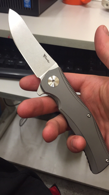

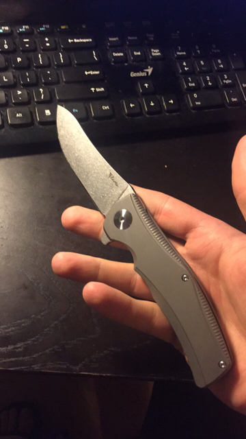

And some random photos of the Hills here and there
