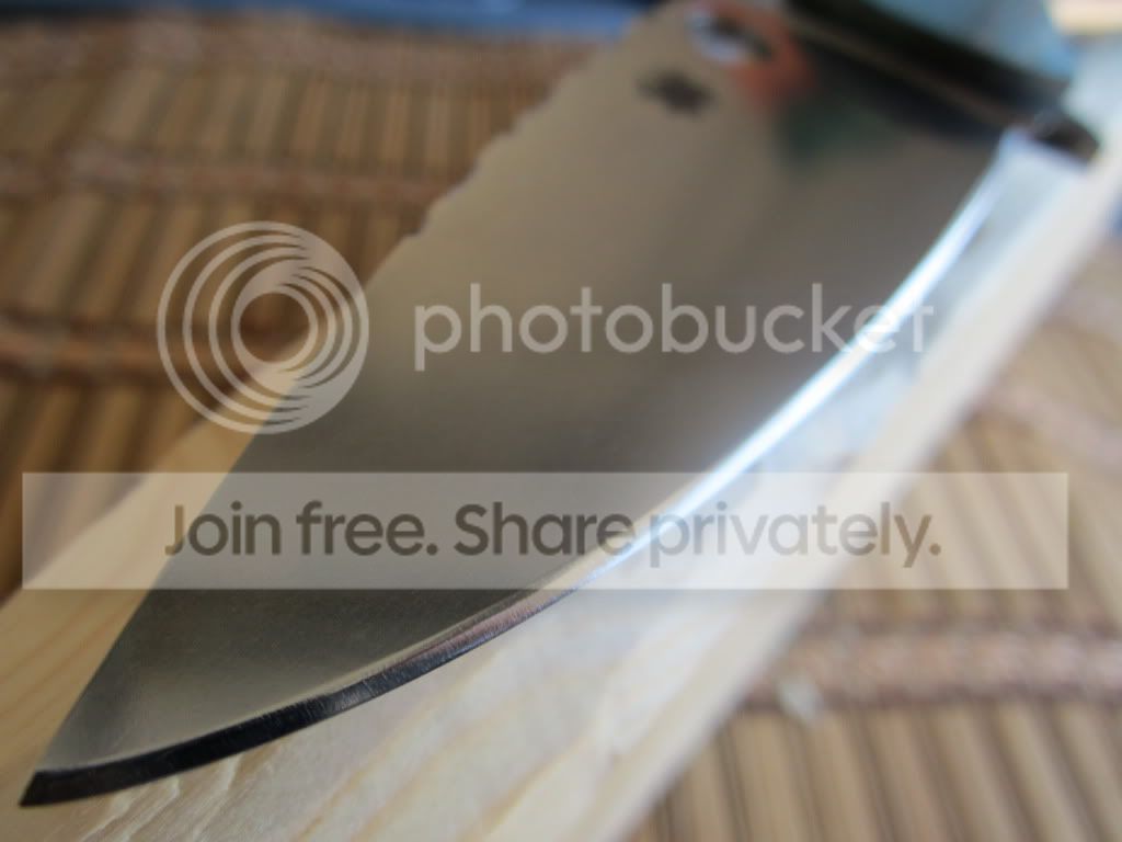

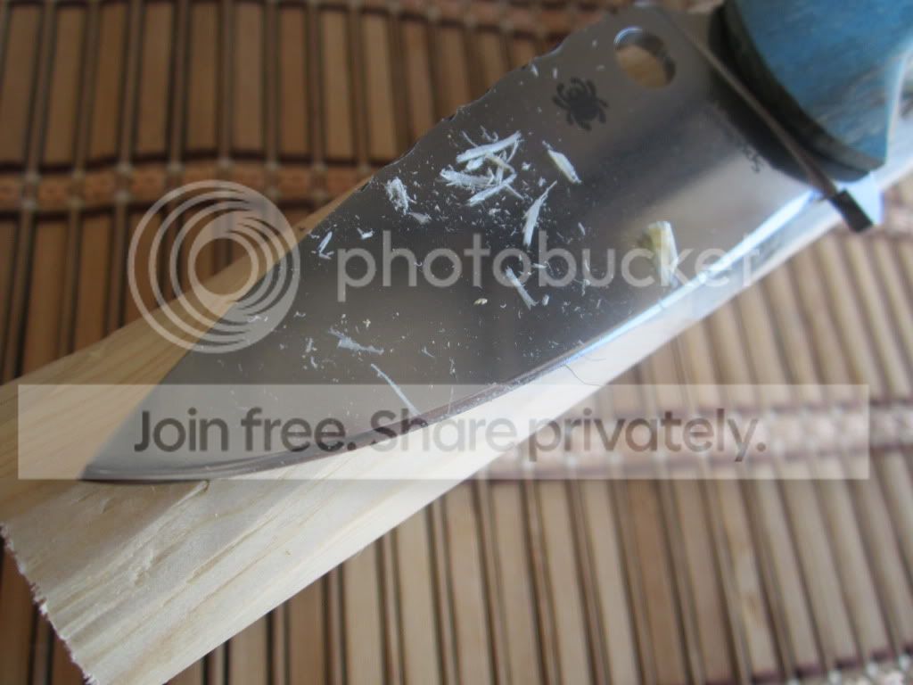

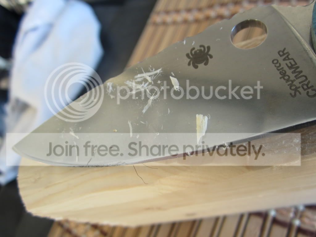

So exactly what IS the problem?My Cruwear is good as gold.I sharpened it up and started on whittling a toothpick with this yellow pine 2x4.It still shaves after without a single line or mark on the blade.I did notice it didnt get real sharp until i polished it (the edge)on a hard buffing wheel.
Maybe you got a good one. The first one I tried sharpened very easily, but the edge rolled stripping the bark off an ash tree limb even at 45° included angle with a 50° microbevel. The second one was much better, but still showed some rolling with a 40° microbevel after a little whittling on that ash. I know it's hardwood, but it isn't that hard. The timestamp on this thread makes me think Sal's testing showed something seriously wrong with the pieces still on hand.
Yea,mines seems fine.Extremely hard in fact.I wont send it back unless Sal or crew wants to examine it or something.Hopefully,ill get to cut up a few deer with it this season.Im completely satisfied and confident in the knife.
