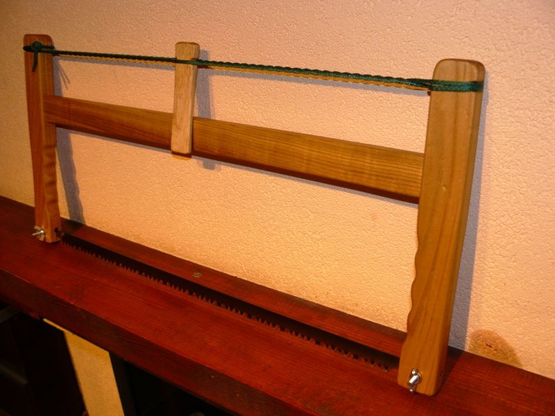

Tonight I whipped up a packable bow saw which was pretty much a fail. I've been wanting to do one, and I totally jacked up a band saw blade tonight. I thought maybe I could put part of the band saw blade in it. Doesn't work well at all. It skips real bad. I'll get a Bahco blade and try it before I scrap it.

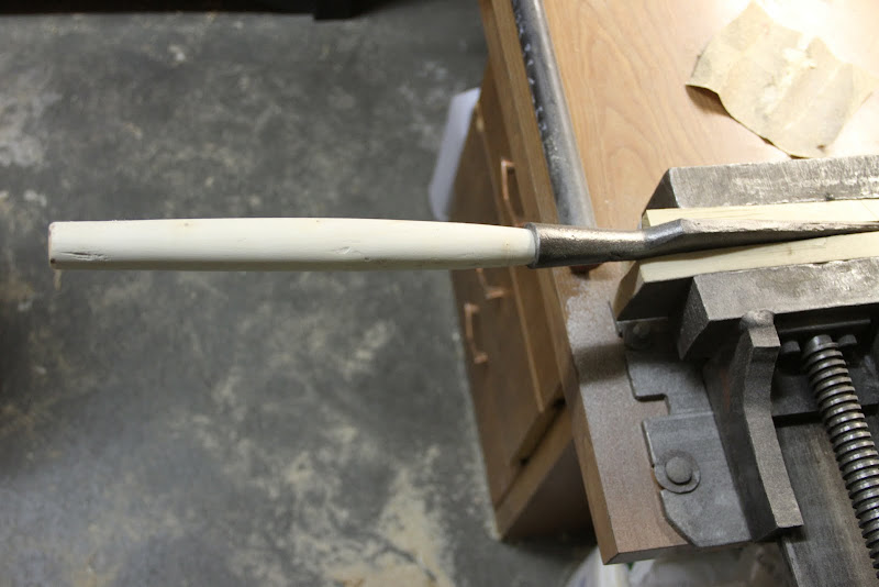

Another "new" toy. 2" framing slick.

Here is a foldable saw I made, is a small one backpack version.

BTW, a 2" framing chisel with a long handle is not really a slick. it can be used sort of "slick like" but its not a slick.
Nice set up you got there, really wish I had some shop space.
For sake of function, a slick is usually determined a slick by the shapes on it and not the size. I have seen 3 inch chisels with rhe geometry of a flat framing chisel, this wouldnt work well as a dressing tool because the flat back wouldnt allow you to back out of a cut. The same reason why some wood workers use a (nicely shaped) back bevel on a draw knife. I always thought a slick had a slight camber to the edge, with a very slight convex shape from socket to edge.
What kind of geometry features you got on that chisel M3mphis?
I'm not familiar with a slick, is it like a larger paring chisel? Looks like you had a good day (couple of days?) in the shop. I'm envious! I get just a couple hours here an there. I wish I could find a decent axe 'round here, everything I find is either Stanley, new Collins, or Chinese.

Thanks, Leon! I'm going to rebuild mine. It will be a lot better if I use a better wood. Do you think you could post a close up picture of how you did the joint between the blade and handles???? It looks like you have a slick method there!

I honestly don't know the answer to this. I thought it was a slick because everything lays flat. The socket is offset enough that the whole piece can lay flat across a timber, whereas most chisels can't do that.
Here's the backside of it:
Here you can really see the lamination:
I could get a better pic of the profile today.
