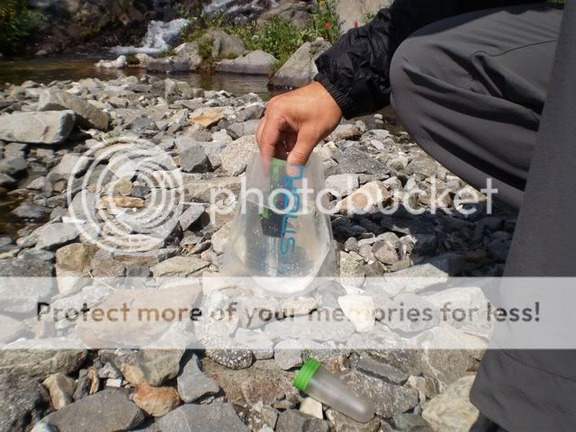

I purchased a Steripen Opti earlier and the year and have had it out on several trips- I'm now officially sold :) Previously I was using Micropur tabs, liked the weight, didn't like the wait (the taste of Chlorine wasn't terrible, but it's not mountain water taste by a long shot). Before tabs I used several different pumps- heavy and would get heavier as you went, would clog, temperamental and not that convenient.
It weighs 3.6 oz w/ batteries (two CR123's) and will treat ~ 100 liters per pair of batteries. It's easy to use, collect your water (1/2 or 1 liter), hit the button once for 1 liter, twice for 1/2 liter- submerge the "pen" and stir- ~ 90 seconds for 1 liter, 45 seconds for a 1/2 liter- no need to count- the light goes out when it's done :) You have to use containers that are Nalgene bottle size or larger- that was a problem for me as I like Platypus bottle- they are light, but still plenty strong. They are a little tough to fill however- problem solved- I cut a 2 liter platy bottle ~ 3" above the 1 liter mark. Now I have a container that stands up, is easy to fill, can use w/ the Steripen and easily fill my platy bottles all for 0.7 oz :D
