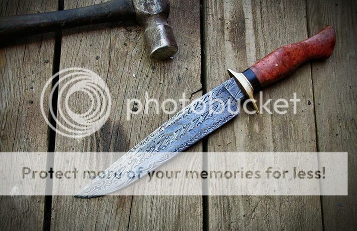

Next up is a pattern welded bowie made from the leftovers of my mom's wedding rings. The steel is 1095 and 15n20 with three bars of standards twist and three bars of twisted jellyroll pattern. The guard is brass with water buffalo horn spacer and madrone burl. (over all length 15 1/4 inches)
