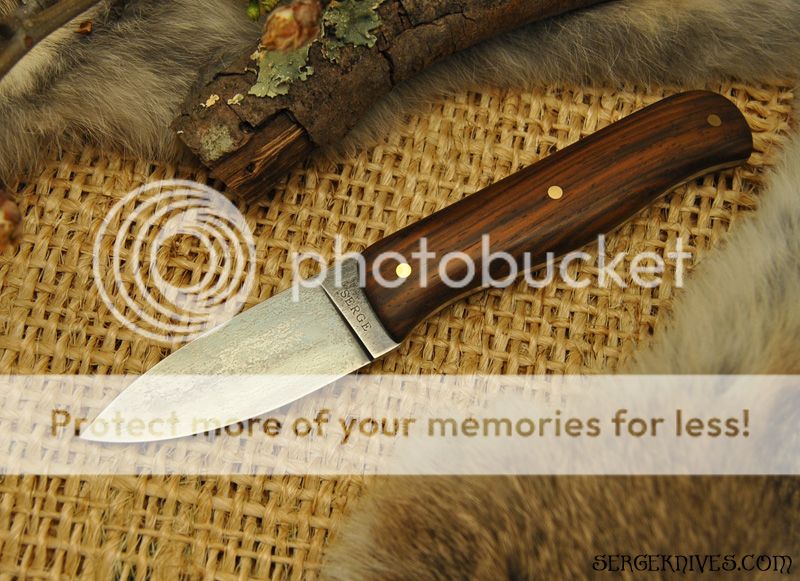

Cocobolo and an antiqued blade.

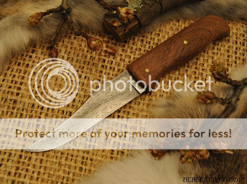

An attempt at a 1800's era simple bowie, Mesquite handle, hidden tang.

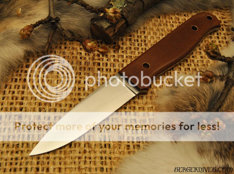

Brown Micarta handle.

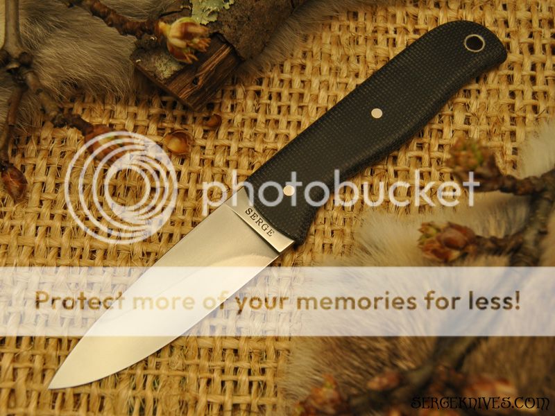

Black canvas Micarta handle, hidden tang.

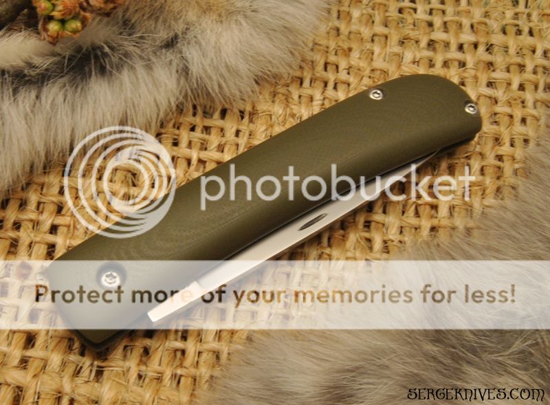

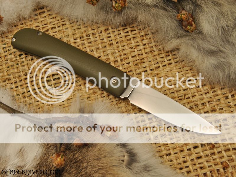

This is my third folder, a slipjoint in 1080 and green G-10.

I really love that antiqued look on the first two blades. Could you share how you get that look? I'd love to try it sometime.

I'm not really into folders, but that slipjoint really is lovely.

I always look forward to your threads Serge. Good to see you venturing into folders :)
Thanks guys. Mike, spray the blade with Super Blue and dip the blade into bleach for 2-5 minutes, the rub all the rust off with 600 sandpaper, etch the blade in ferric and buff.
