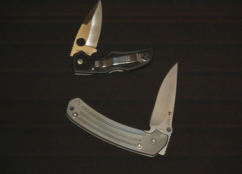

This is a kit from Knifekits.com , I believe it is a Darrel Ralph design.
This is my 7-8th kit ? I forget how many i've made , this one is FL-001
http://www.knifekits.com/store/s-pages/kk_store_1mainframe.htm?kk_products_folderkits_main.htm~smain
Good basic kit for the beginner , easy to modify and build :thumbup:
I did some reprofiling on the frame ,changing the shape to my liking , I also reshaped the tip of the blade some to match the change in frame.
Simple "clamshell" filework on backspine area, pocket clip was also fielworked but turned out kinda funky , tried to do something different with the present holes.
Used my own 'custom' stainless steel washers , verrrrry smooth opening , walk and talks nicely , locks with a decisive 'click'.
Thumb notches on top and notches on the lock.
Scales are beautiful African quilted mahogony , my camera skills do not do the wood justice , tons and tons of chatoyance in the light.
Thumb stud , pivot screws , scale screws and clip heat colored.
I worked off and on , on this knife for about 5 weeks an hour here two hours there.
I tried to make a real backspine for it out of aluminum but messed up and gave up , maybe i'll give it another go next kit.

I would have radiused the bolster just a bit more and done the clip differently.

The clip file work is good. They are so often left plain, with the rest of the knife getting all the attention.
I actually disagree... that specific filework (I understand it didn't come out as you intended, happens to all of us) looks fairly absentminded. The one other thing is I would've made sure that the edges of the overlay were perfectly flush with the surface of the liner and/or inset them some, also radiusing the outer edges of the wood. And although I appreciate the idea of heatcoloring the hardware to give it an individual touch, I think that the gold gives it too much "bling" dis-appeal.
But hey... who am I to complain, when I haven't done jack! (and it's not like I wouldn't carry that knife if it were mine, either)

Thanks! In retrospect I overdid it on the clip , shoulda left the holes round , the rest of it i'm pleased with though. I usually decorate all my pocket clips in some form , even on my production folders.
Lucky Bob I actually disagree... that specific filework (I understand it didn't come out as you intended, happens to all of us) looks fairly absentminded. The one other thing is I would've made sure that the edges of the overlay were perfectly flush with the surface of the liner and/or inset them some, also radiusing the outer edges of the wood. And although I appreciate the idea of heatcoloring the hardware to give it an individual touch, I think that the gold gives it too much "bling" dis-appeal.
Thanks :) I am quite open to criticism, as it only serves to point out flaws I might not noticed. I went pretty silly on that clip , a few cups of coffee and I was all over it like a pit bull on a poodle and you see the results... lol
Yea , the frame and wood do not meet perfectly in all places , would not be too difficult to fix that.
The heat coloring turned out okay I think , I wanted more of a blueish/purple instead of the bronze/brown , but it did add some interesting contrast I think.

The kits are 17.00 $ a pop , nice and cheap for some educational fun :)
Blade steel is AUS8 , not bad at all , especially for the price.
Tools..... Well if your lucky enough to have power tools like grinder , belt sander , etc then your set aside from torx drivers , files and grades of sandpaper and a vise comes in handy...
However if you have nothing , you can still build the kit with just the correct size Torx.
I did mine in my "shop" which is my kitchen lol. I use my vise , different files , and several grades of paper from 320 grit to 1500 , I also have wood finishing goodies , tung oil and beeswax etc..
If you just wanted to build the kit plain you could easily do it inside of an hour although you will need to file the blade a bit so it locks perfect. You will understand once you see the kit.
I also Heavily recommend one does the following.
Read the instructions a few times and ... Lay all parts out so you can see whats what. There are a few different sizes of screws and some only go in certain spots.
The blade comes pre-sharpened but I reprofiled mine to a thinner edge and a 'pointier' tip. Also the kit comes stock with nitrolon washers , those stink IMO , go with the phos bronze washer upgrade or make your own like I did.
bottom line ? The kits are cheap in cost , and so-so in quality , comparable to maybe a lower end CRKT (IMO), the finished kit seems a little flimsy to me , even with steel washers and loctite.
Still though they are fun and if you wish you can always give them away to friends and family like I do :D

The design in and of itself is far too gaudy for my tastes. However, I like the workmanship of the kit and the assembly you performed.
I think it would look much better if you polished the metal still in the white to remove the lines, and removed the glare from your pics.

Thanks for the honest critic :) it only serves to point out flaws I have overlooked and proves what is acceptable and unacceptable to folks , I appreciate it.
The lovely thing about these kits is I could do exactly as you pointed out (and I will) with ease, simply remove a few torx and off I go ! :D
