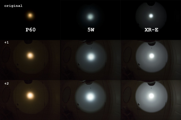

With the current Cree LED's, you can get a drop-in that is significantly brighter than your current lamp, with a longer runtime as well.
Solatek, Dealextreme, Wolf Eyes, G&P, BugOutGearUSA, and some others have models available. The cheapest is the DX one, at only $12.50, and although the quality isn't as nice, it's very bright. Quality control is a mixed bag, but for the price it's worth a shot. I have a couple of them and they stack up just fine against my Solatek unit, pictured here in the right column.
(P60 stock lamp, 5W luxeon, Cree Solatek)
I used to have a lot of beamshots comparing some different Cree drop-ins that I have, but my old web hosting account expired and I can't find them stored locally at the moment. As you can see from the above though, the Crees are quite bright, and my unit pictured above isn't even as bright as what is currently out there.
The Wolf Eyes units seem the most solid, if you're willing to pay the premium.
Then, depending on the voltage range of whatever unit you choose, you could run it off of a single 17670 li-ion or a pair of hi-voltage RCR123's.
