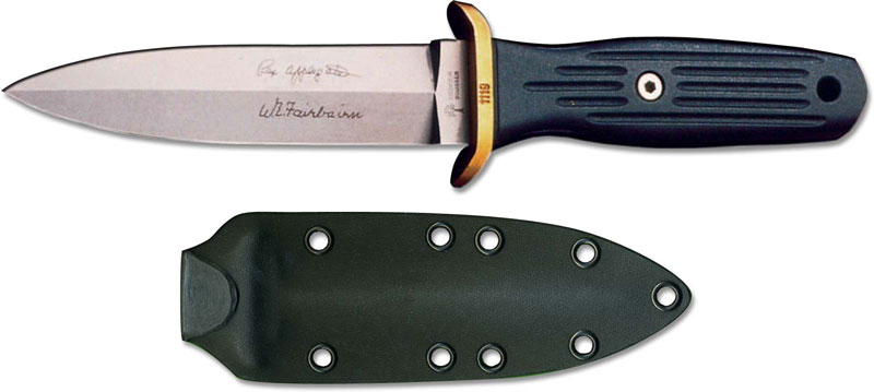

Boker Applegate - the smaller version
I totally agree with this one. One of the best pure fighter designs. The one mentioned is the Boot knife version, 4.75" blade, 440C steel.
The handle has removable weights in it to give it the very good balance.
Another good point is that there are trainers available for it.
