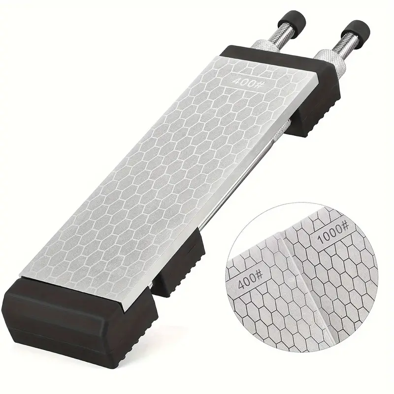

I'd considered that one and bought one of those from another supplier for about the same money and it included an adjustable holder. That deal wasn't offered anymore. I've been seeing on here where some were giving favorable reports on some Chinese diamond plates. I was hoping some here would help me find something. Using search only gave some generalities. So I looked and found this one for $31 with a holder.. I decided to try it. Hope I don't regret it. It's 7.9" x 2.7" x .3"

I have the 400/1000 diamond plate from CKTG, cost me $30.00. Stills costs that much. Works fine. Google CKTG Diamond Plates. He also stocks the very good Atoma plates which are good for sharpening and waterstone flattening.

Sharpal brand 325/1200 grit diamond plate is getting very good reviews lately and supposedly has less lower grit contamination on the finer grit side than others. I have a cheap triangle 400/1000/8000 (8000 is ceramic, others are diamond) from the big river site, same honeycomb pattern as the CKTG one, and it works very well at around $30, even on S90V, Magnacut, Elmax, CPM 20CV, etc. I have water stones from like 150 up to J nats 16K+ range and honestly, just use the diamond plate and some leather strops with diamond compound on them and haven't used my water stones in a while. Faster, less messy, easier to get a nicer edge, less expensive, etc.
Link below is to a post here on Bladeforums showing some of my sharpening tools, including the S SATC 400/1000 diamond plate 8x3 inch size for $22 currently on the river site. (Note space between "S" and "SATC" in the brand name.) It's the plate I use & find it to work well.
The Sharpal 162N is the 8x3 plate that Outdoors55 on YouTube found to be free of grit contamination, but it costs around $70. So the S SATC plate above offers better value on a strictly cost per square inch basis.

Thanks for the good recommendations from all of you. This thread was slow getting started and so I assumed everyone was tired of answering the same old questions. I'd heard more than a few reporting that they had like some of the Chinese plates on other threads, especially the one where I said Chinese plates were junk :), so I went ahead and ordered the one from post 3. I'm hoping it works out well and since it came with a holder for about $30, I went with it. Should arrive soon and I hope it works for him.
