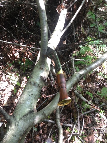

My opinion for 1) is: like most forum members have said the BSI is a great choice for a hiking partner and camp use. I also think the ugly villager Kukris are even better for your specifications. They are built for one thing: work. They are perfect for hiking in the 17 to 20 oz weights.
Above picture by jroden54
