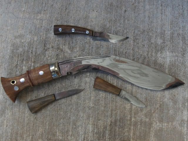

You might like something like the 28 ounce 18" GRS shown on the bottom, it has a 3/8" thick blade. Above it is a 24 ounce Chit, above that is a Gelbu(sold), on top is a 29 ounce chiruwa BAS.
The GRS would be the best chopper in my limited collection, in my opinion. I'm 6' 200 pounds and in good shape. Others might say the BAS because of it's weight and 7/16" thick blade. It will also depend on how a knife feels in your hand. Comfort is key, not just weight. What good is a knife that you can only swing for 15 minutes?

You might like something like the 28 ounce 18" GRS shown on the bottom, it has a 3/8" thick blade...
...on top is a 29 ounce chiruwa BAS.
The GRS would be the best chopper in my limited collection, in my opinion...
...Comfort is key, not just weight. What good is a knife that you can only swing for 15 minutes?
I'm struck by how the top knife in the photo weighs more than the bottom knife, even though the bottom knife (Ganga Ram) is longer.
And the lighter Ganga Ram looks like it has a better grip for big hands.
Nice bevel, not too blunt.
I have a similar 18 inch GRS that weighs a the same 28 oz and I like it a lot.
I agree that the 18" chitlangi and gelbu are a good utility size. I have both in villagers and plan to use them. To me the villagers seem to be the best choice for users. I just can't bring myself to use the polished models yet. Just seems like a shame to ruin such a nice polish job. On the flip side it's also a shame to have such a capable knife and not use it. The 18" chit or gelbu seems like it would handle lite chopping with ease and just about perfect for heavy brush clearing up to 1" branches. I have a large brushpile that I will attack in the spring and one of these will be my weapon of choice.
Steve, I agree it is interesting that the BAS at the top of the photo weighs more than the GRS even though it is shorter, but the combination of the BAS being fulltang and having a thicker blade that carries it's thickness well towards the tip does it. I have a large hand and the GRS feels better with the larger handle so I'll be letting go of the BAS. I must say the BAS really does take a bite out of trees with it's weight. I just wish it had a handle for a big hand rather than an average hand. I don't hold onto knives I can't use. That was the problem with the Gelbu, it was made for an average hand.

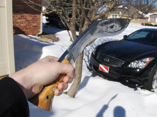

For those who wanted to see the 16.5" olivewood ASTK, heres a link to the pics. Some are before I sanded and put a few coats of tung oil on it. My R7 is also in the early pics.
