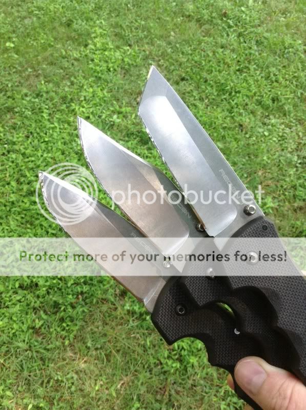

So, with nothing to lose but a can of Mineral Spirits I decided to give it a try. About an hour soak ( which did not work well) and 20 minutes of careful work with a razor later this is the results. I skipped the clip because i like how it looks. The full sized Recon is in perfect condition so i'm going to keep it that way but this is how my Mini looks now. There's a somewhat mirror polish while maintaining a beautiful dark grey stonewash.
Please excuse the late response and my dirty hands in the photos. Been working on the truck all day.
In my opinion it's way better than the black coating. It even makes it look more high value. The dark grey is awesome and where the grind meets the flats the lines are pronounced. I would definitely recommend doing it.... BUT get a better substance to strip the parts. Mineral spirits barely did anything. You could probably do it with only something like dish soap just for a bit of lubrication between the steel and the razor since the steel of the blade is way harder than the steel of the throwaway razor. I didn't detect any scratches on the blade and at some spots i had to do some decently hard scraping. Be careful with the rocker/lock bar, though. I did manage to scratch that in a couple small spots. You can't see them without disassembling the knife but it's obviously not a very hard steel.

I'm not surprised it came off with the mineral spirits and a razor... The stuff is basically glorified latex house paint. (It sucks)

I did my recon by scraping it all off. Used a screwdriver and made a burr with a grinder at right angles to the screwdriver blade, and used the burr as a scraper. When it wore out I whipped up a new one with a quick pass on the grinder. Screwdriver is lower RC than the blade steel, so no scratches, and it pulls that coating right off. No pics, but they definitely look better without the coating.
