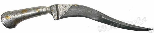

middle eastern daggers are also found with recurved blades, this one of mine is double edged and razor sharp on both of them, was described as an assasin's dagger.

Oh wow !! That stuff just blows me away, that is such wonderful information. Thank you for sharing that with us. That Rajput Sosun Pattah just looks so familiar, where have I seen THAT before. There really is nothing new under the sun!
