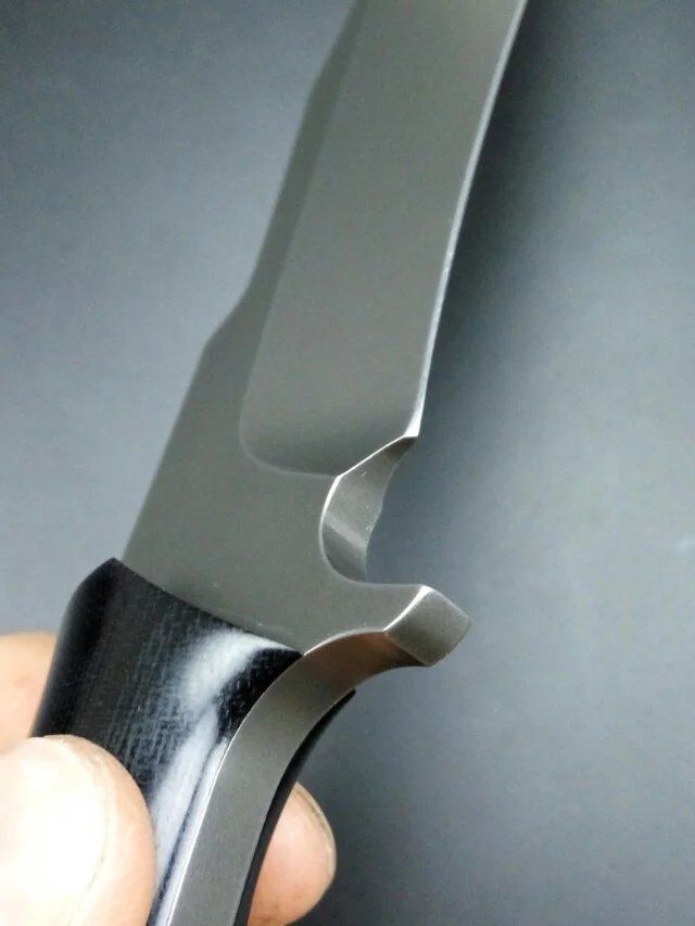

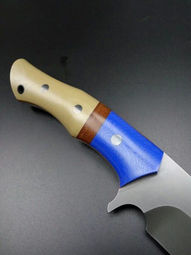

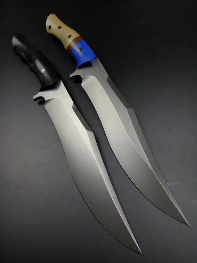

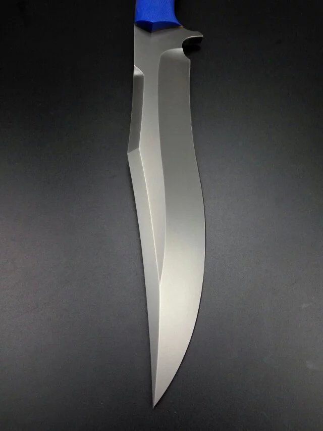

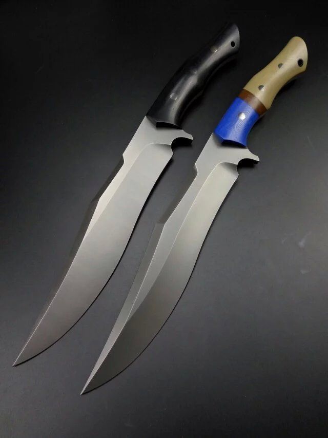

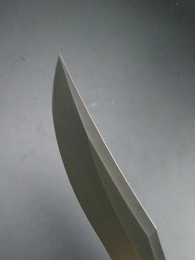

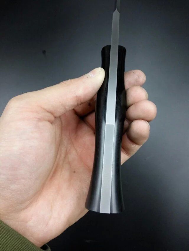

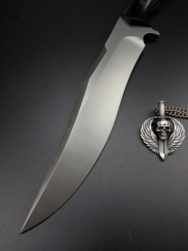

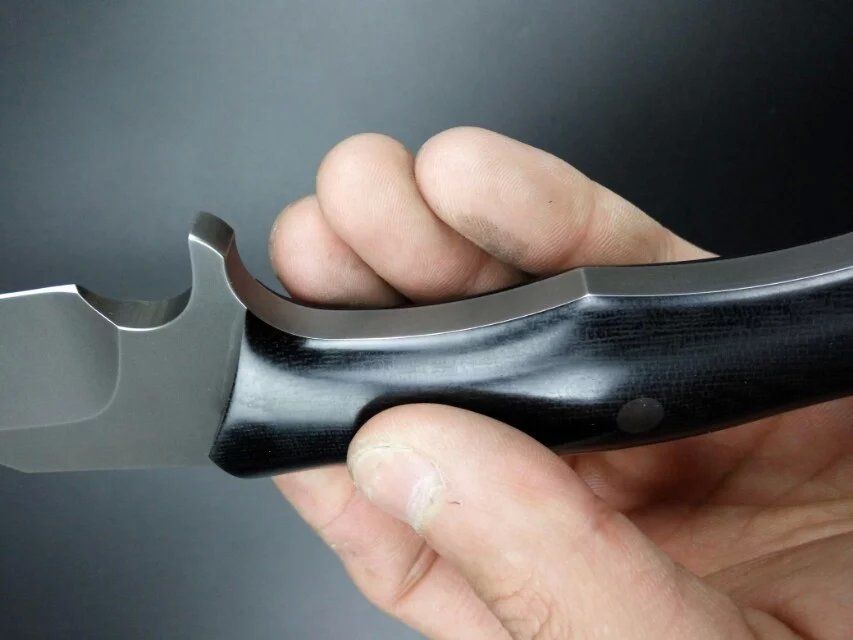

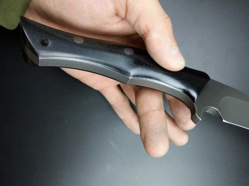

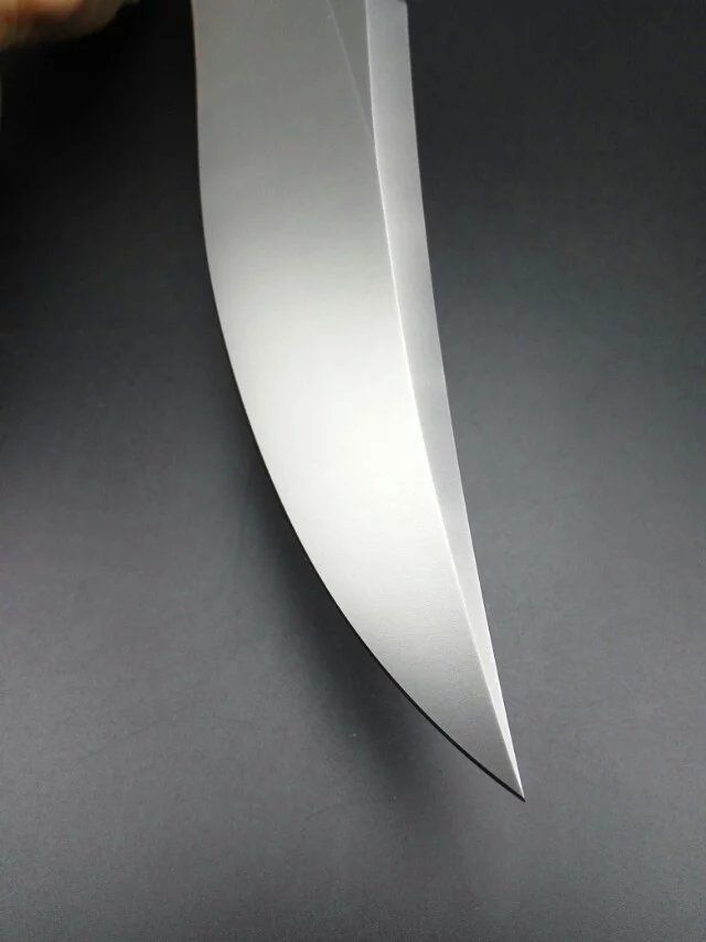

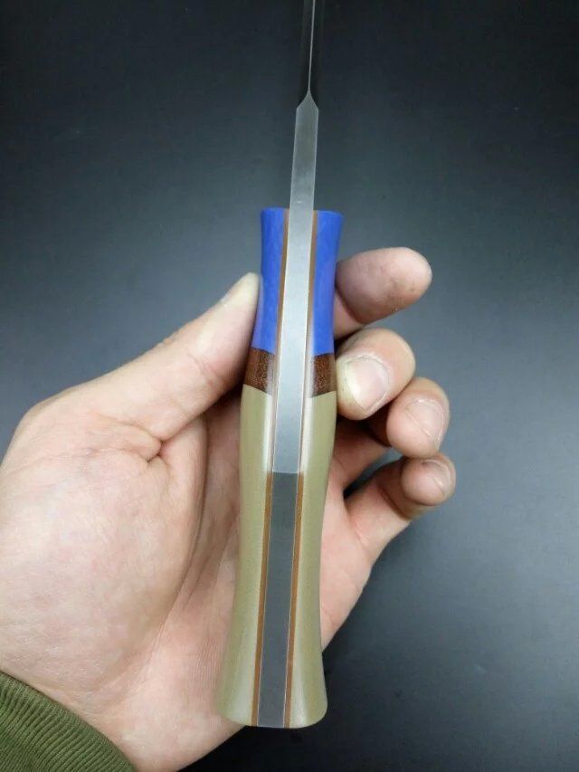

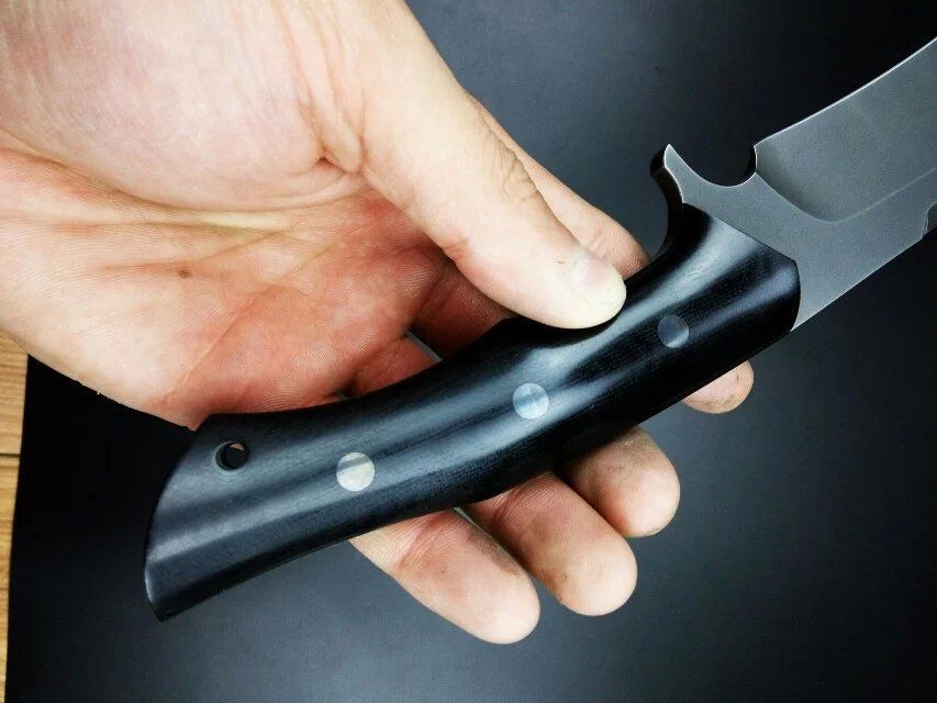

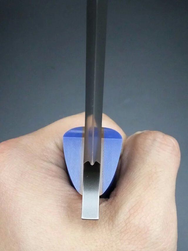

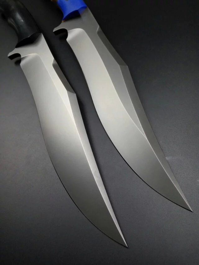

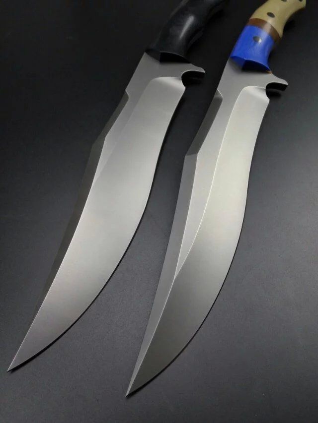

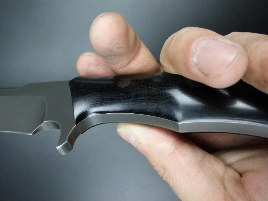

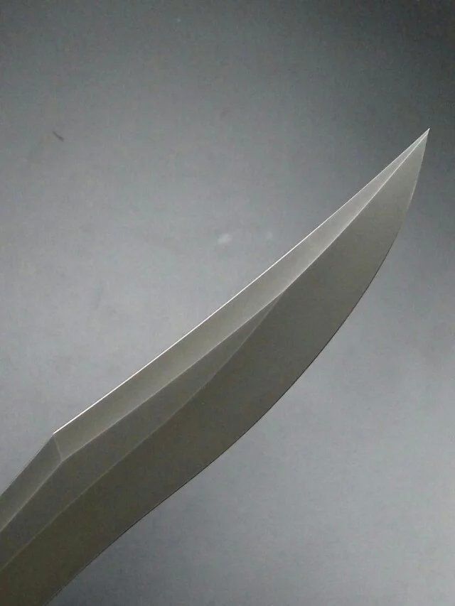

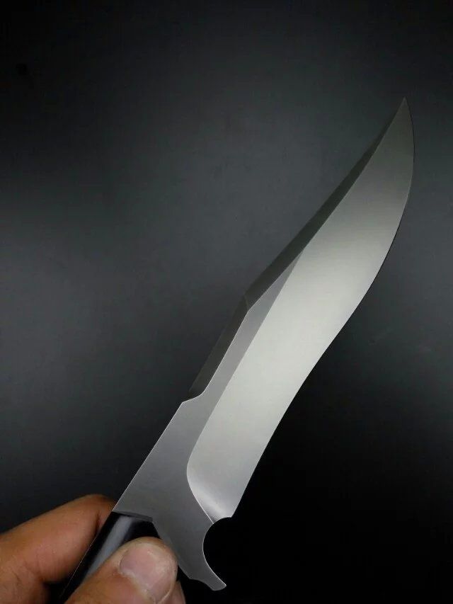

Hi,

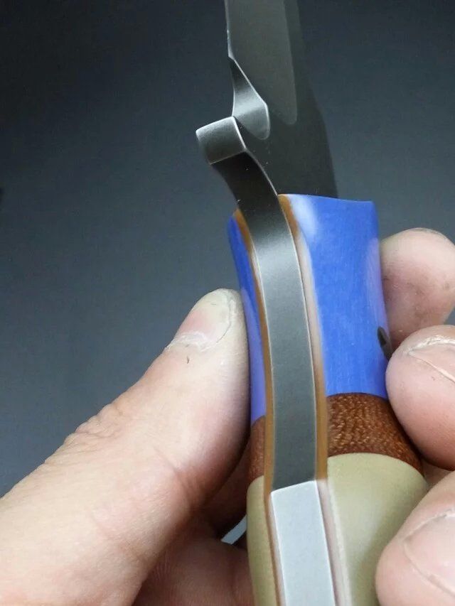

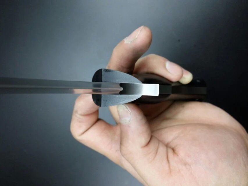

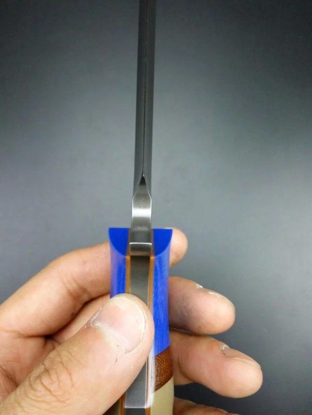

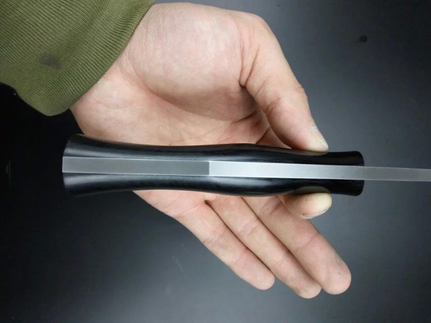

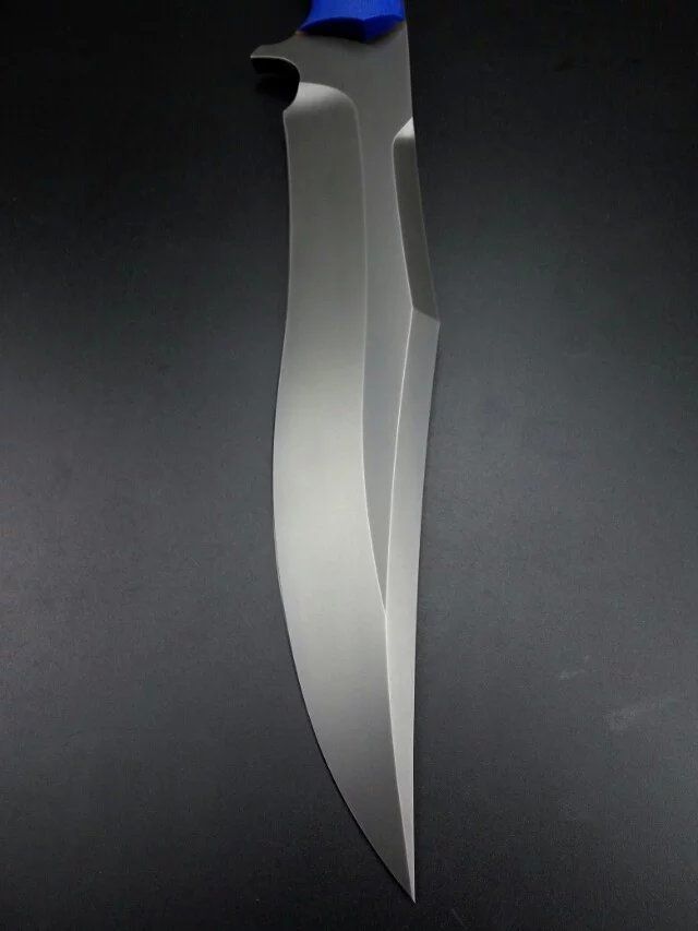

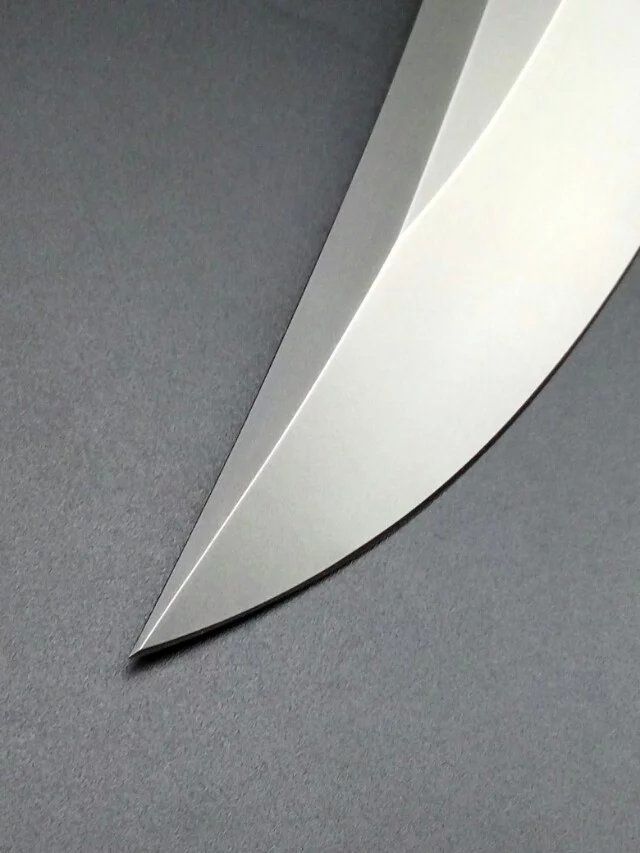

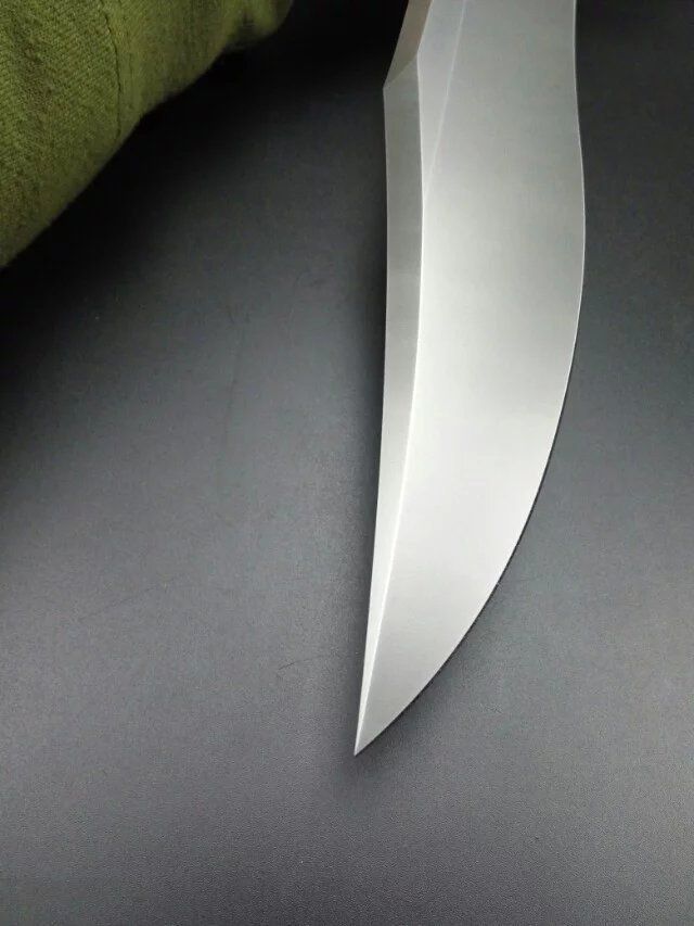

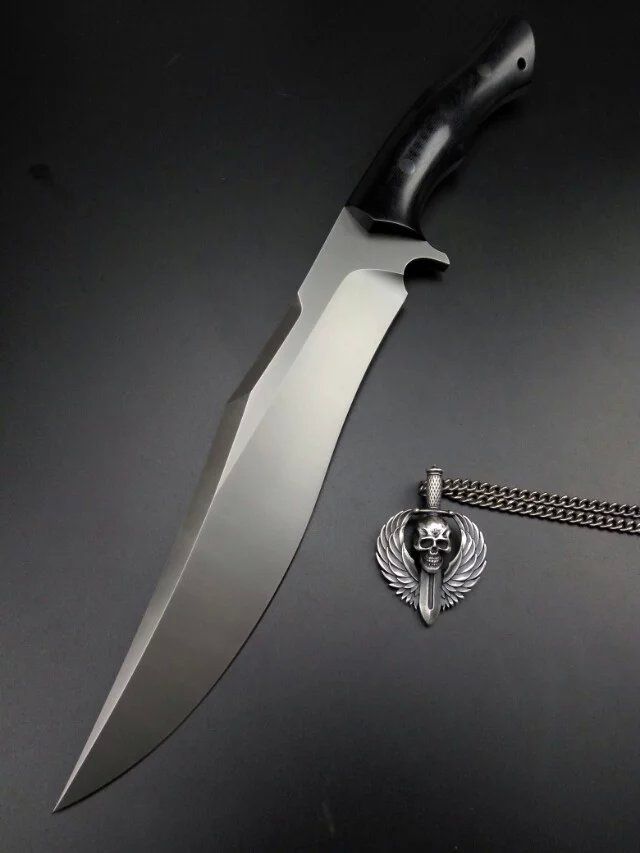

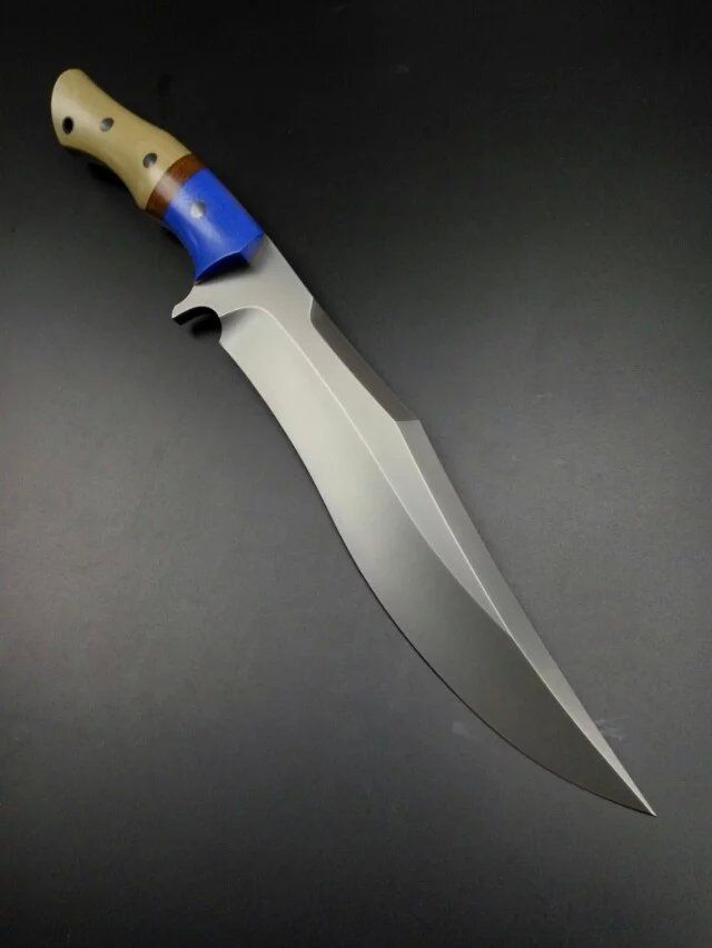

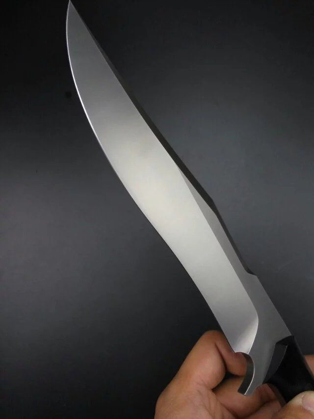

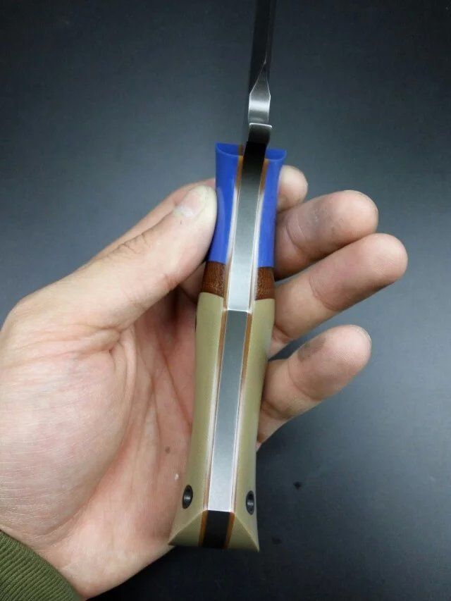

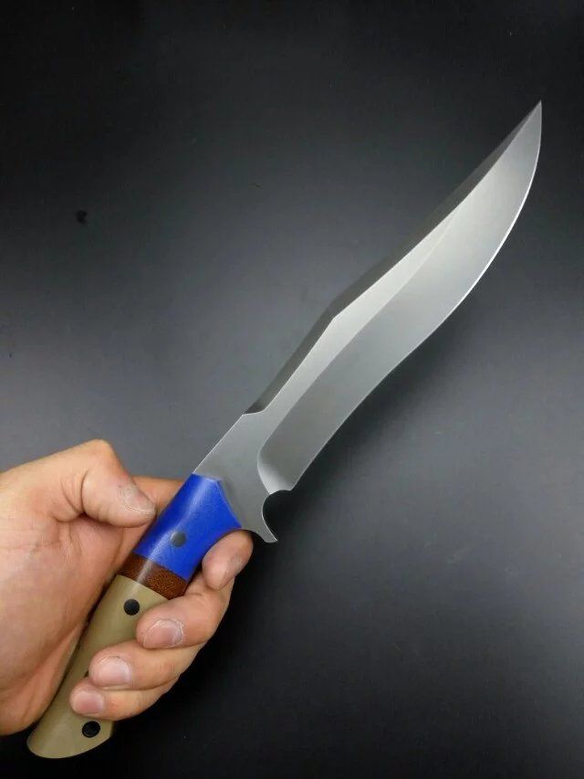

here is the another set of recently finished,made of A2 tool steel at 58-59RC, I use two type grind way on them,one is adjustable angle flat grind with false swedge,the hollow grind one have sharp back edge.Both of them use solid copper pins and fiber tube.all the handle polish out.
Thanks for watch!
Repect,
J.bin
Miracles sometimes occur,but one has to work terribly for them :) I like them :thumbup:
J. Bin.,
Looks great. I especially like the higher grinds on the black handled knife. Can you tell us more about your process? Do you machine the blade or cut the bevels on a belt sander?
J. Bin.,
Thanks,I did all the knife grind on a 2*72 belt grinder,I did free hand grind,no Jig or work plate,I think this will be easy to control by jusy bare hands.
