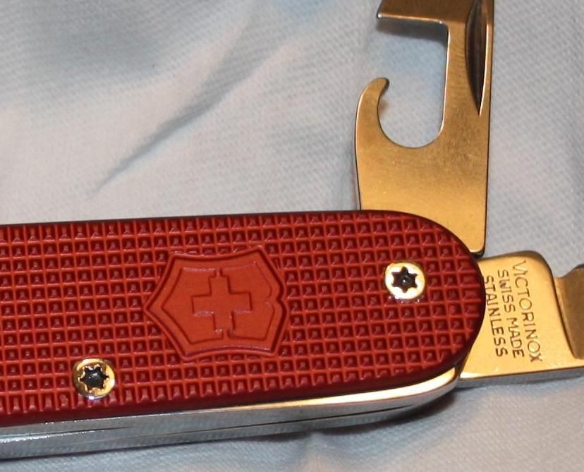

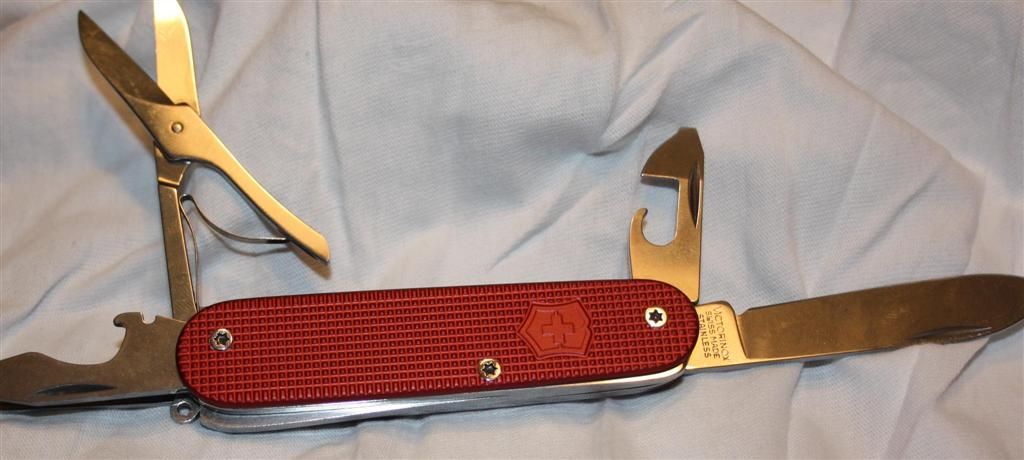

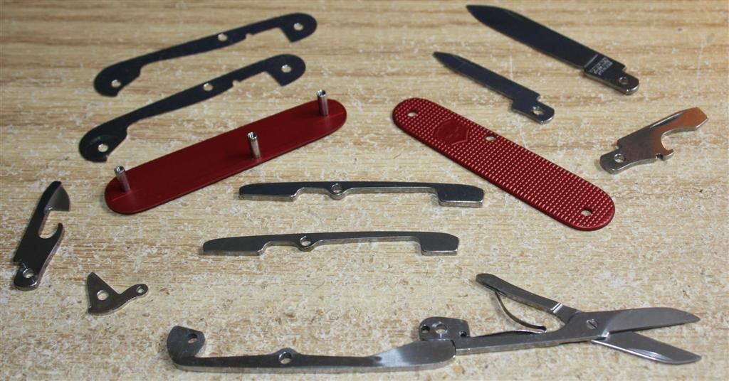

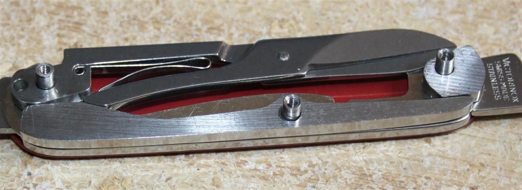

Took me awhile to figure this one out, but I wanted to put scissors on an 84mm cadet, and 84mm scissors are hard to find now since they are discontinued. I ended up grinding down some scissors from a 91 and making them fit with a moved pivot hole.

Woah, that's awesome.
Where did you get the new pins/fasteners and how did you get the old ones off?
Those are 1/8 inch pivots cut to length with custom ground screws. Just about all the knife parts supply stores carry the pivots, knifekits usaknifemaker etc.
