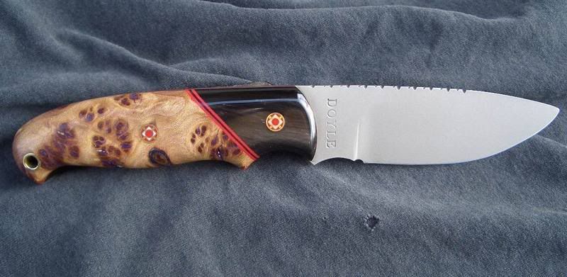

Here's a poor pic of one I did a couple years ago w/elm and water buffalo horn. Not sure if it was red elm now??? Also it may have been quoted as being spalted elm burl.

Here's a poor pic of one I did a couple years ago w/elm. Not sure if it was red elm now??? Also it may have been quoted as being spalted elm burl. I just don't remember now. Sorry
Matt Doyle
Yes it absolutely was stabililzed. I wouldn't use it if not. Send it out and get it done. It works pretty easily, I do remember that much. That's a nice set of scales, don't waste em without stabilization.
Matt
