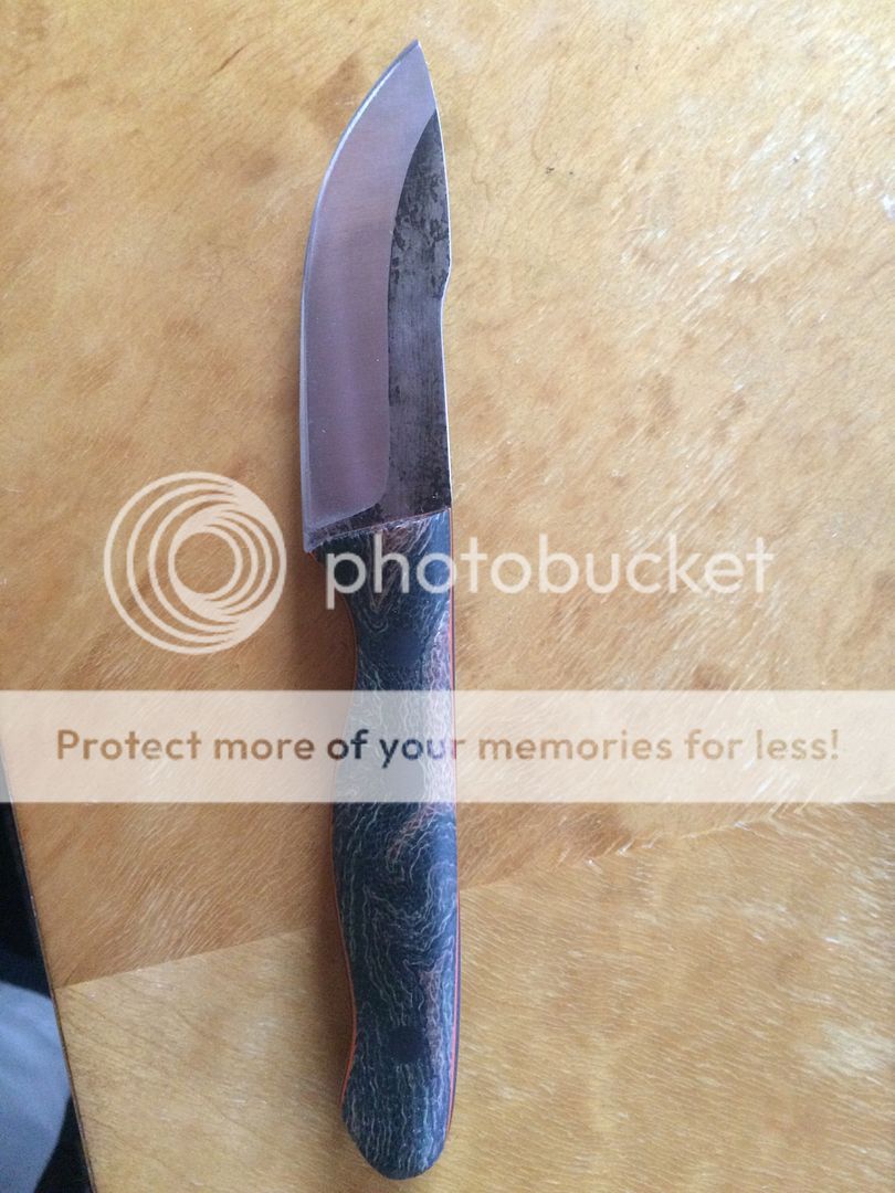

Specs as described: Nuki-te w/ Tsunami burlap over black w/ orange pinstripes, SFT Tang, convex on 5/32” 01 steel, 3 5/8” blade, 8 1/8” oal - $160
I received it a couple of weeks later after some discussion regarding sheaths. It will fit a sheath pattern based on the FF hiking buddy if it has not been wet formed to the hiking buddy.

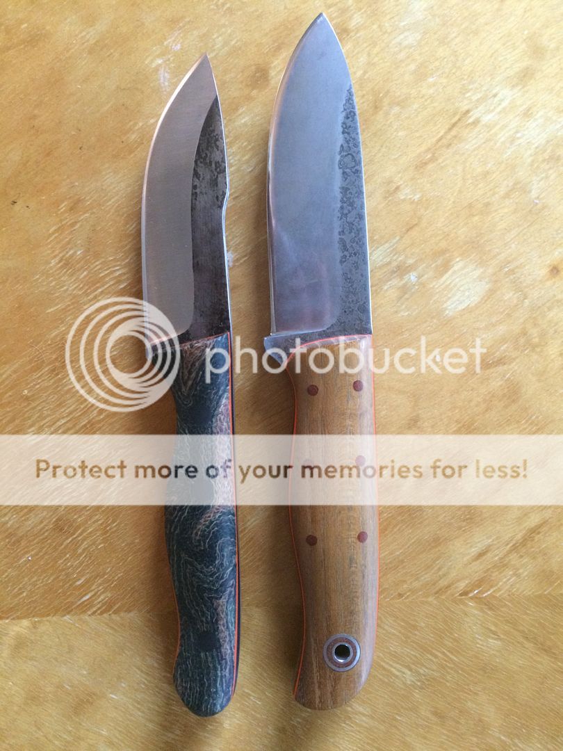

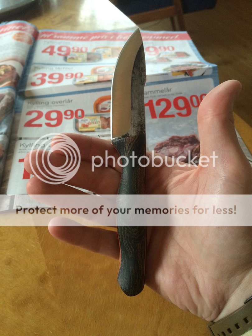

First impression: Well built, no major faults in glue ups, nice even (handmade) grinds, smooth handle, nice color combo, No makers mark or lanyard hole. Does feel a bit slim in hand ( I wear size L in mechanix and well as Arcteryx gloves), Fairly thick stock and maybe a slightly thick grind. The handle is very contoured with a major palm swell in the middle.

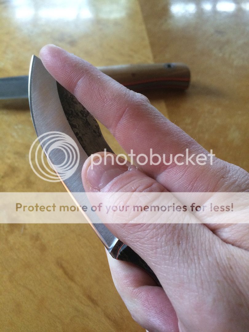

It came paper cutting sharp with a good user edge. The edge is a convexed secondary edge that is pretty pronounced in comparison to the blades from FF. The ramp on-top of the blade fits nicely with my thumb or index finger and renders more power or control into the cut. I think I see a Fletcher influence here.

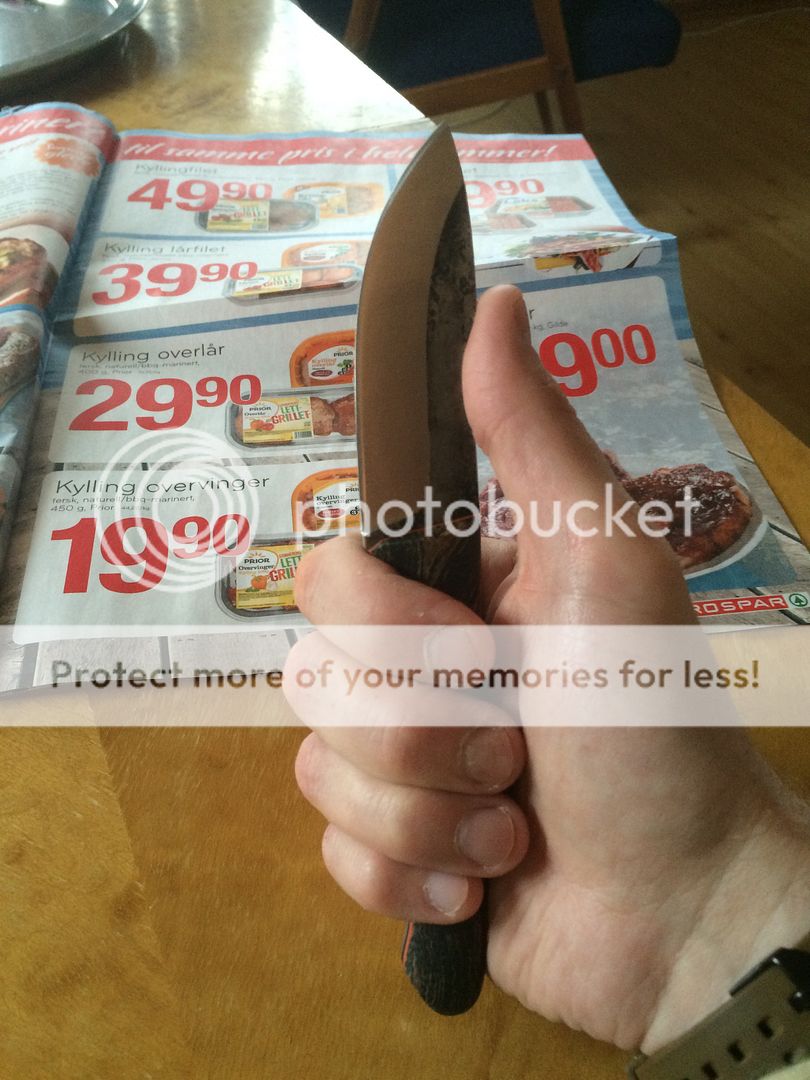

Grip: the Nuki-Te offers a multitude of options for various grips, It is by far one of the most cunning designs Ive seen in a while as It is really an extension of the hand. It may also be its only downfall. In my opinion (and hand) the only grip in which it does not feel secure in is the standard grip. It is slim and under heavy use it does tend to twist in sideways in my hand.

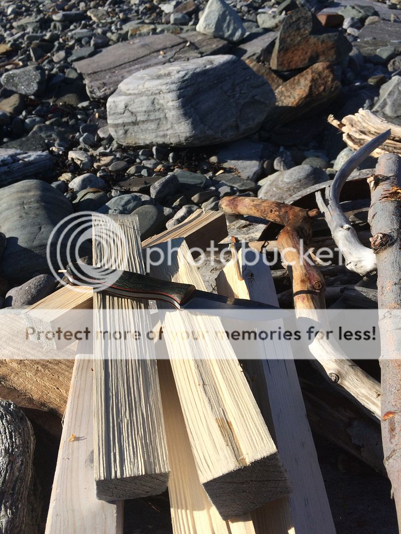

Use: Batons thin wood as a champ, no abusive tests done, whittles and carves as a knife should do, again I do see it twisting a bit in hard power cuts and I think I would see a major improvement with a slightly thinner grind alternatively thinner stock.
Conclusion: Never regret getting this but it may not be my personal favorite blade. I do feel that is falls in-between two categories of knife, EDC and hard use field knife. It is however a bit thick for being an EDC cutter and the handle is a bit too slim to be hard use for me.

Mistwalker, you are right that the grip would improve with a taller handle thus improving index finger control. It is mainly in the index and middle finger area I find it twitching. I guess I could have pinpointed that in my review.
