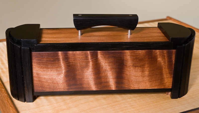

I put too much work into a knife to use anything uninteresting in a handle. If it is unfigured, I'd be tempted to consider it for presentation boxes or something like that. (in which case, stabilizing probably wouldn't be required.)

I've used un-figured woods before to do wood laminates for small knives and such but I think using it to make presentation boxes is a much better idea (in fact I kinda wish I had thought of it:D).
