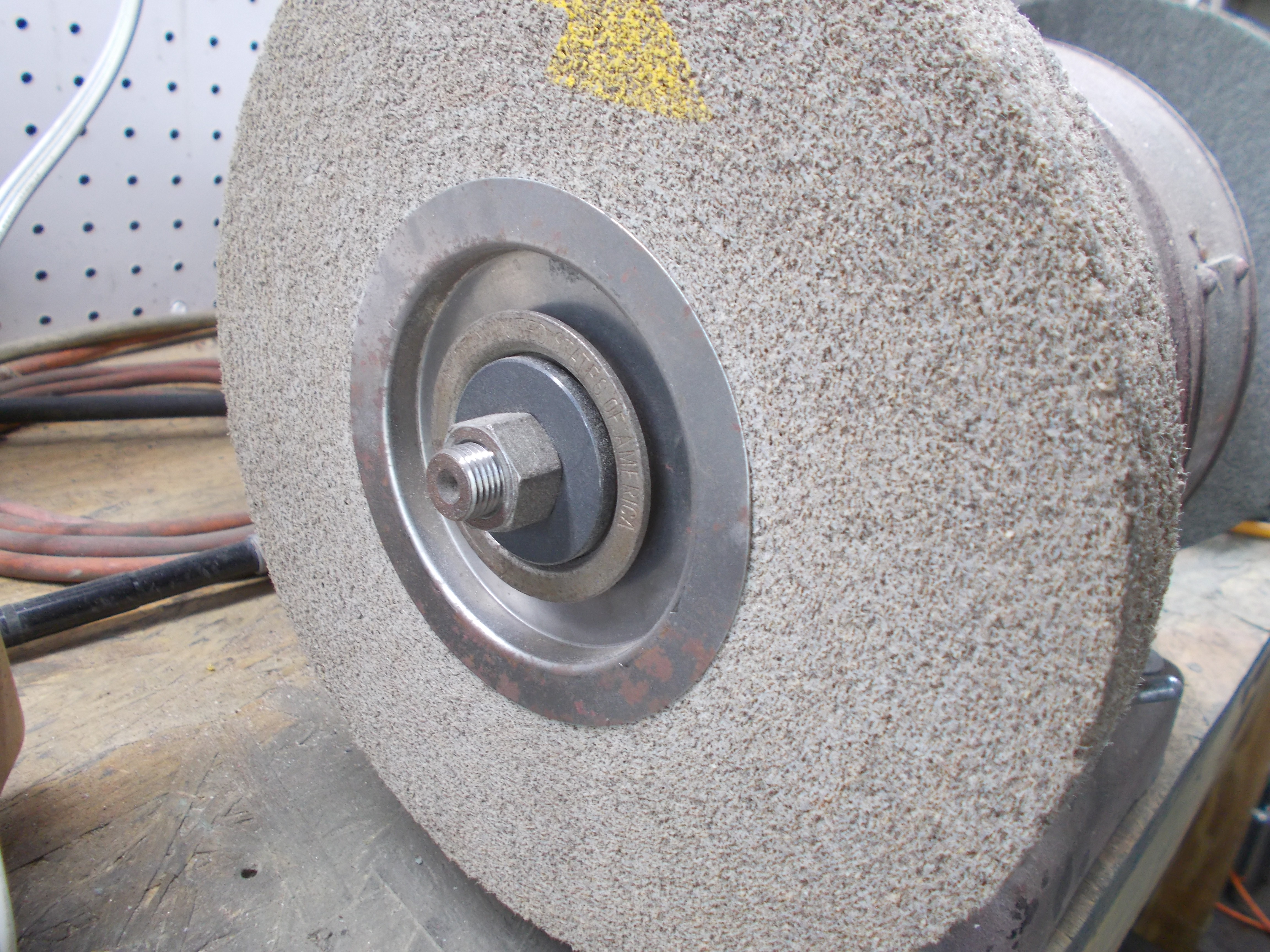

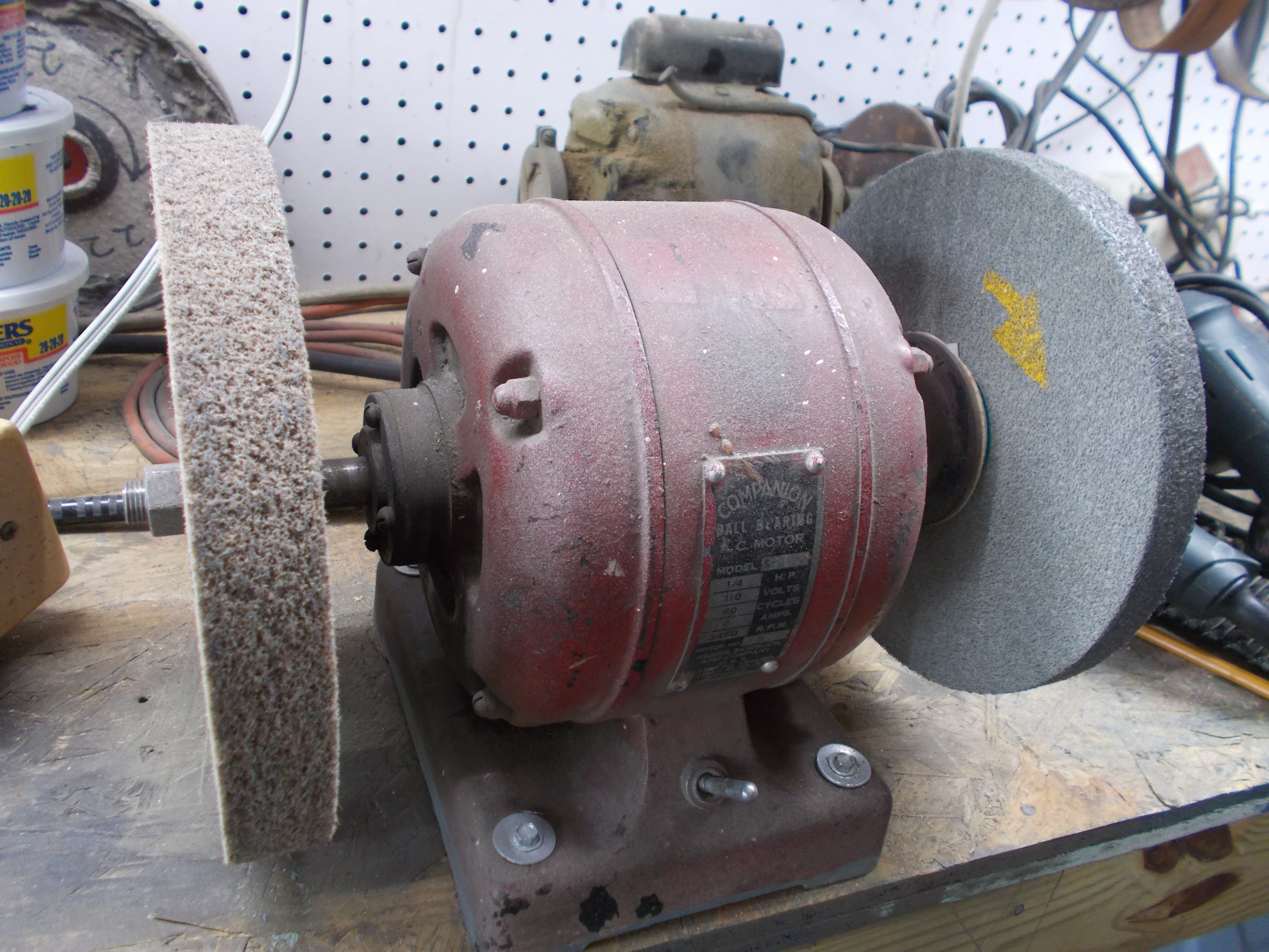

They make reducers for the 1" to 5/8ths arbor. Here is my set up on an old Sears grinder I picked up at a garage sale for $10.00.
I believe the left wheel is a medium and it's the one I use most. This I use at 3000+ RPM, but with light pressure so it doesn't heat up.
I see this wheel actually had a 3" hole that I reduced to 5/8ths.

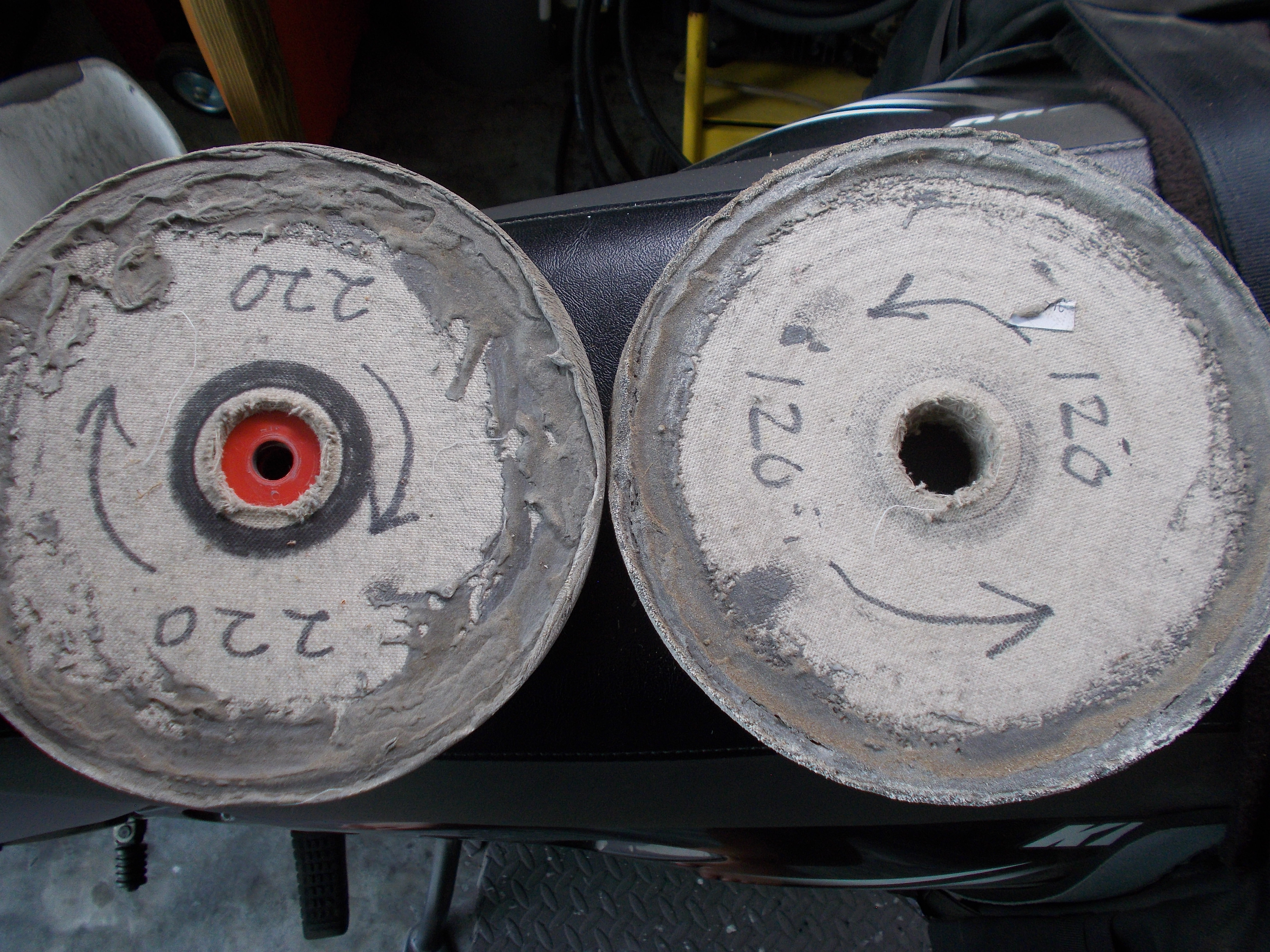

The next picture is of the wheels I made for deep scratches. The aggregate is 220 and 120 and works great for the really deep stuff.
I add glue to the wheel, then roll it in the aggregate before I let it dry overnight. It's then ready to use.

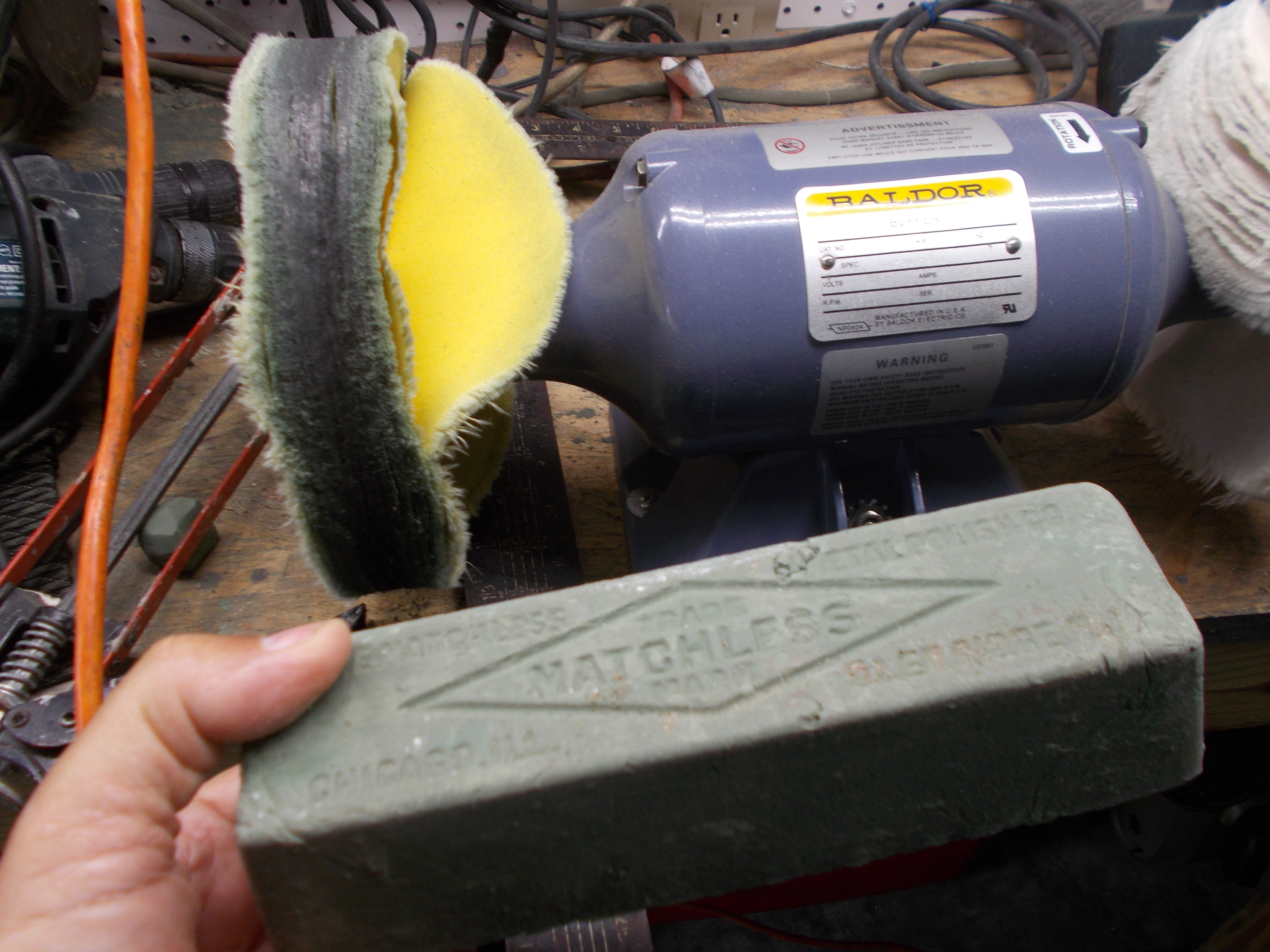

I buff using green to bring out the luster. This is done on the lower RPM like Bert referred to. You have to watch that you don't overheat the phenolic. Go fairly slow on the buff.
I sharpen and strop on a 42" belt grinder.
Most knives can be brought back to near a factory fresh look like this.
My green brick is very green, aluminum oxide. That looks like my grey brick, chromium oxide. You can do it using that as I use the grey on my
sisal buff wheel. It's more aggressive. I do not have a rpm adjustment on my buff motor. So, it runs the axle (all wheels) at 3000. It takes some getting use to. And a miss-step can happen fast. So, I'd start with a slower speed. DM
Yes David, now that I look at the picture it does look gray. It is definitely green in real life....and yes, all my buffing is at about 1700 RPM. I have to be very careful even at 1700 when buffing phenolic.
Yes, agreed. My sisal buff will eat valox handles rather quickly. So, I keep it moving along. And on to the sewn cotton wheel. Then on to the loose cotton wheel you show loaded with the 'pink' rouge. DM
