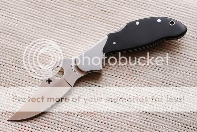

Recently the finish on my mini persian has got pretty dinged up and I am curious what kind of dremel attachment do I need to use to give it that nice fresh brushed look again. Any advice would be appreciated.
Spyderco Mini Persian:I don't know what a "mini persian" is, but you will have to abrade the handles to a point below the scratches and dings. A Dremel is NOT the tool to do this. Wet/dry sandpaper is what should be used. A Dremel has much too small a contact area to get a smooth finish.
Start with 400 grit and sand until the blemishes are gone. Then use finer grits until you are satisfied with the finish. Don't get sanding grit in the pivot area.
