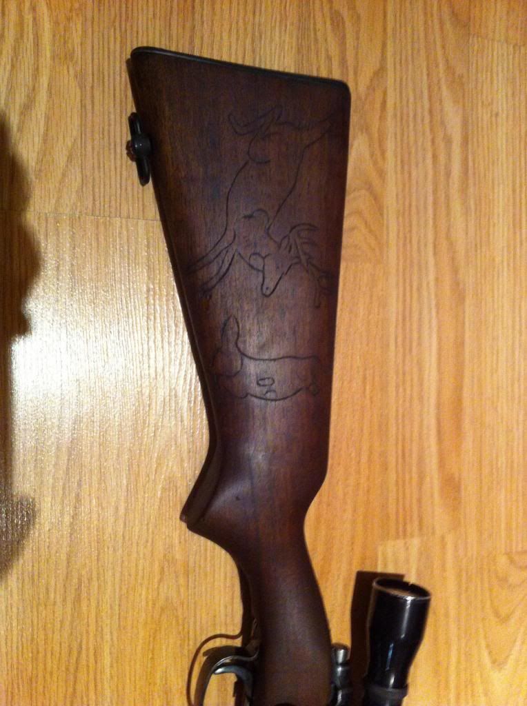

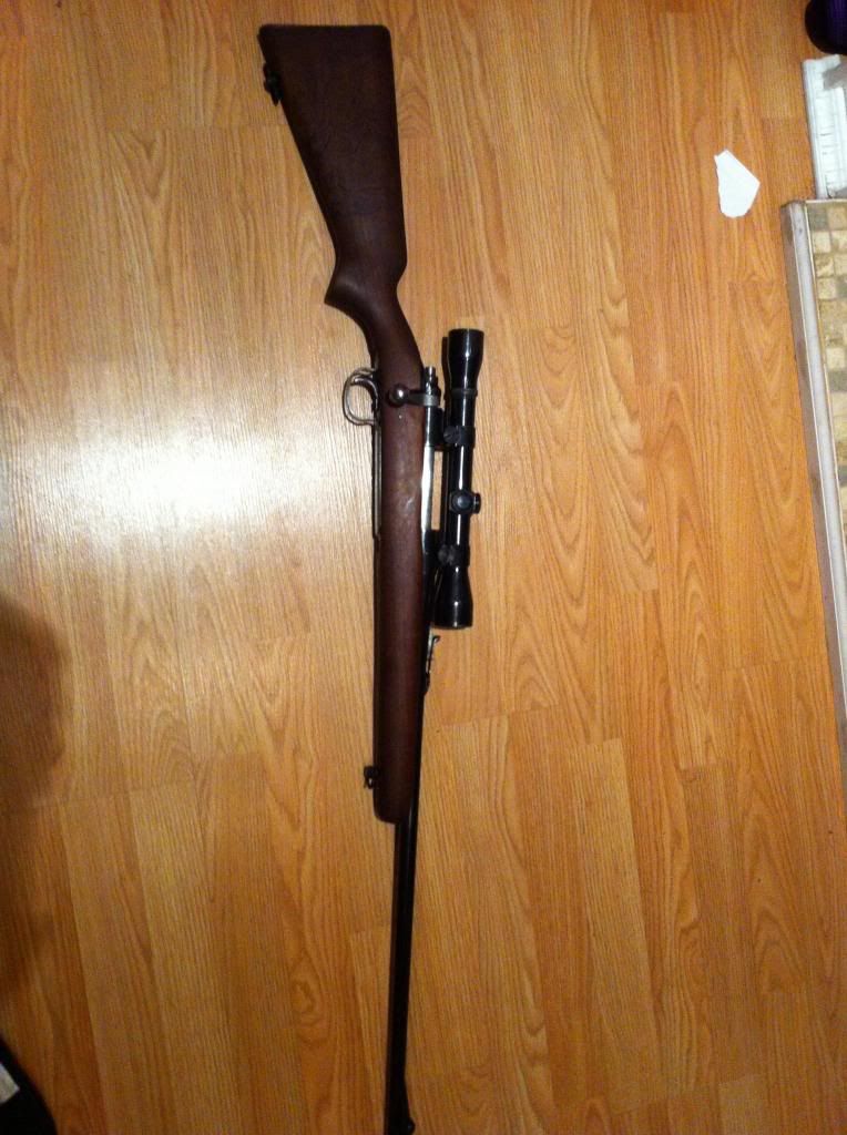

My brother inherited my grandfathers old rifle when he passed away last year. It's a Remington 721, 30-06 with a wood stock. It was well used to say the least. My grandfather had carved some animals into the sides of the buttstock, and it was used to take many animals. Something of a family heirloom now I guess.

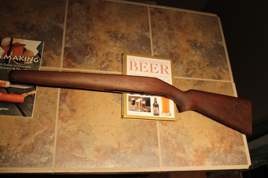

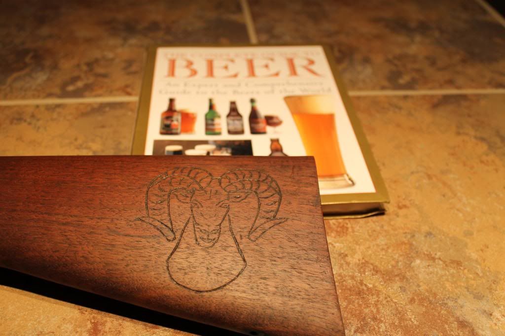

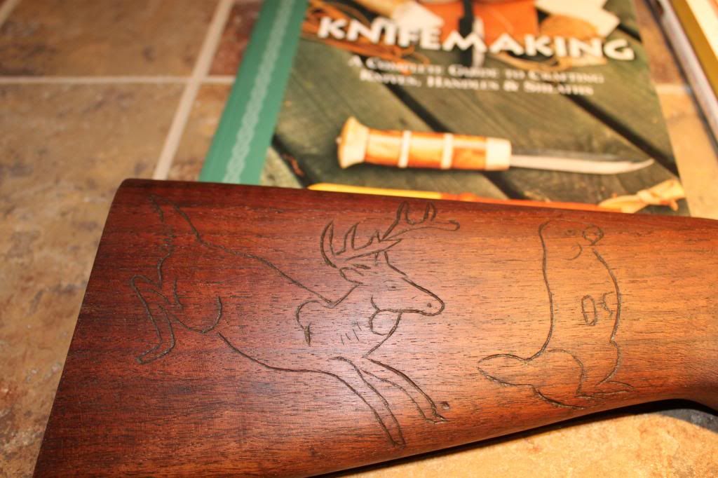

Here is the stock. I have already removed the old finish, sanded it down, and treated it with Danish oil. I had to remove a couple of big gouges, and was careful not to remove too much of the carvings:

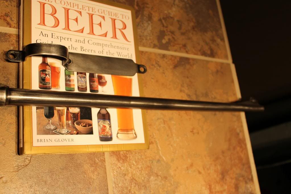

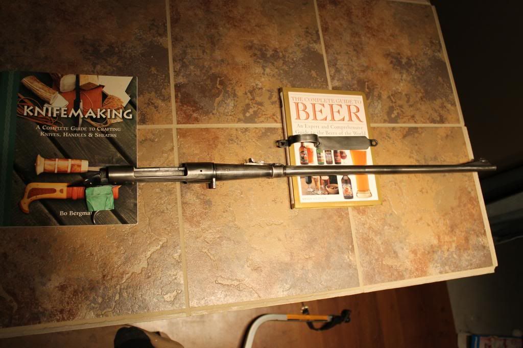

Here is the barrel and trigger guard at 220 grit. I will finish it up to 600 then blue it in the next day or so.

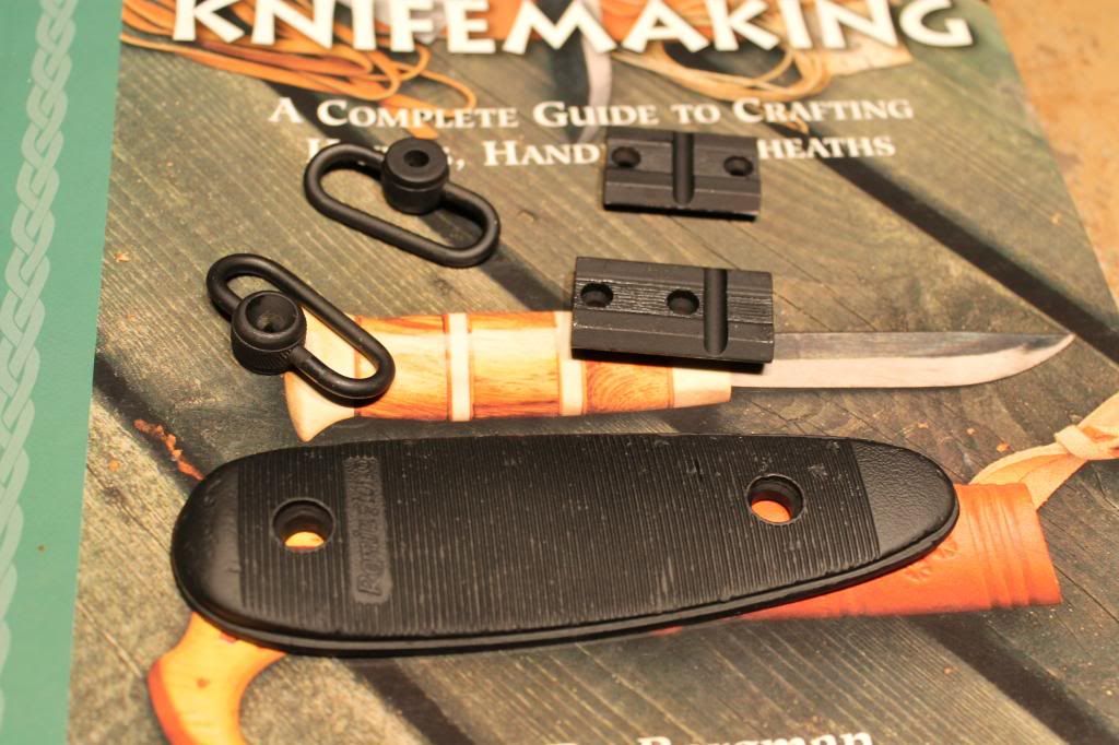

And here are a couple of pieces of hardware that I spray painted matte black:
