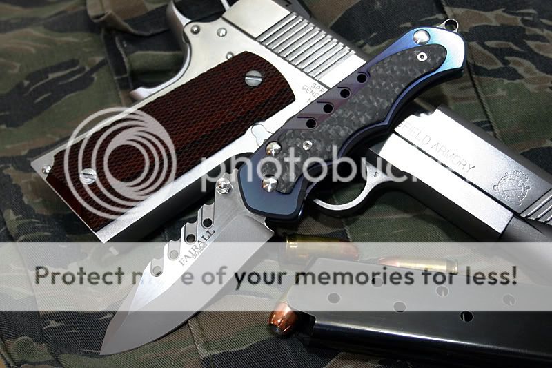

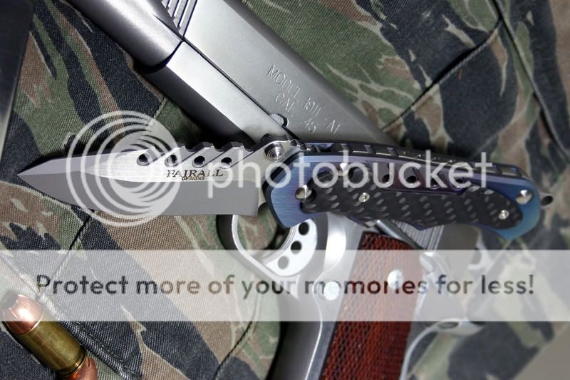

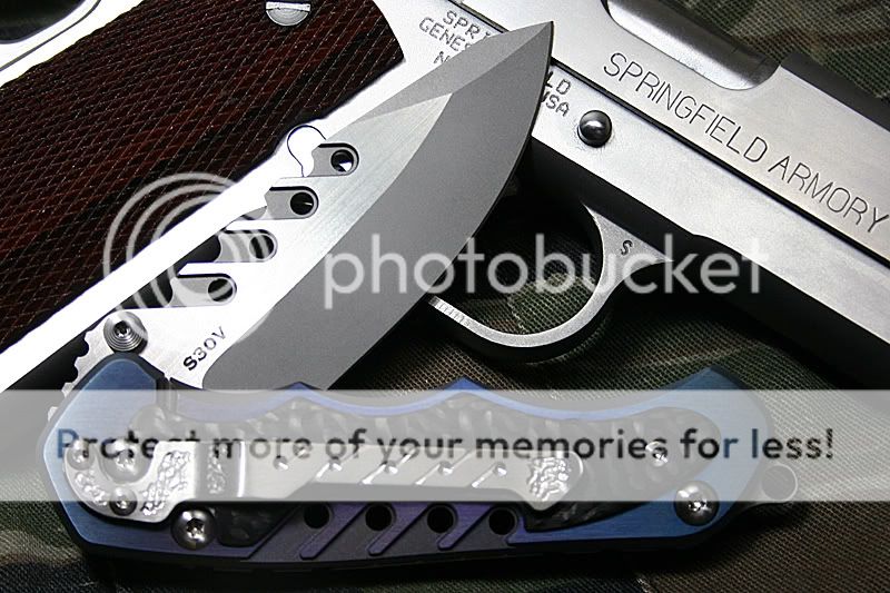

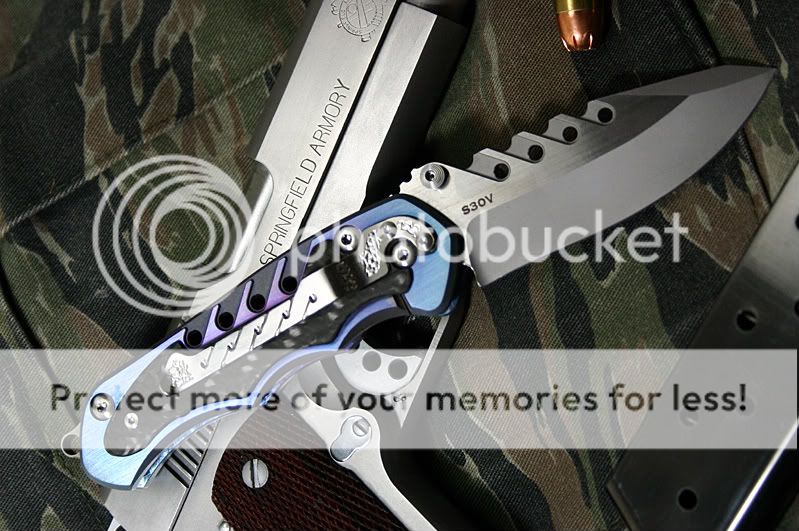

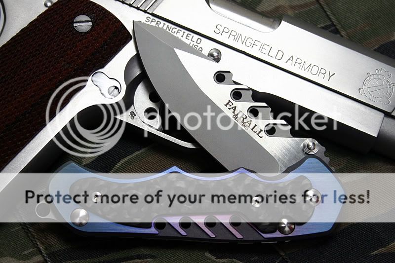

A Reflection in Blue.
I wanted to get some pictures up of this one.
It is sold!
Specs.
Blade: S30V RC 59 two tone finish, .130 thick.
Frame: 6AL4V Titanium 2 tone finish W/Blue annodizing.
Scales: Carbon Fiber.
Clip: 6AL4V Titanium .04 thick with nugget and my celtic knot filework.
Backspine: 440C 58RC. 2 tone finish, celtic knot filework.
Pins: 440C 58RC., engine turned.
screws: 18-8 stainless, engine turned, #10 torx drive.

Beautiful job on that one,very business like,looks right at home with the 1911:thumbup::thumbup:Regards Butch
Thanks guys, I wish I could keep one for myself! Maybe on the second run...lol... Second Reflection run of 50.... now taking orders.
wow... That is a beautiful folder. I love the 'notches' on the blade and handle, the blue looks so nice.
