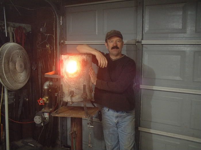

Here's mine I just re-did after two years of Damascus forging, as well as all the other knives to support a full time knife living.
Top and bottom remove with bolts.
Inside looked like it did the last time I lined it.
This is after coming up to heat for 15 minutes.
Where my palm is was 55 degrees, and on the top was 57 degrees.
One layer of wool over the entire length and two layers up to the bottom of the window.
Two layers in the top.
Coated with about 3/8" Satanite.
