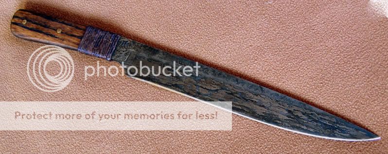

I was selfish today and just messed around with my own gear.
Rick
Before...

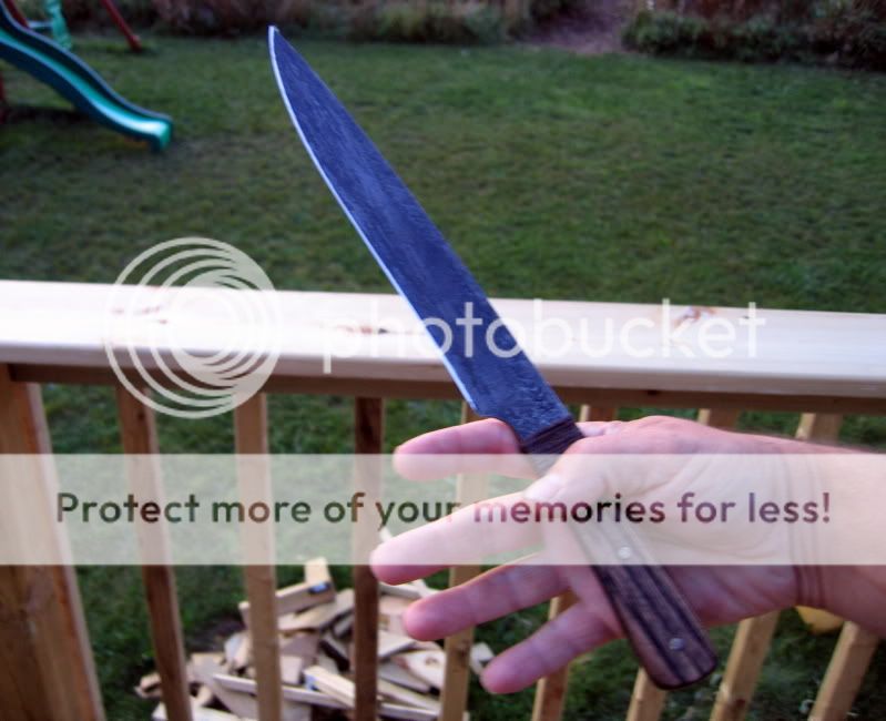

After...
No downside Mist... Just wanted something new and I really like that hemp wrap I do know.
Rick
I was just wondering. I have seen no negatives with the Bushlore but the dynamics are a little different with the smaller blade. I really like the feel of the leather handle scales and Sarah has never voiced any complaints.

What did you do to the finish on the blade? Looks great.
Even though you are a selfish arse..lol
I like the new look alot. How did you get that finish on it?
I like both the before and after...you do some great stuff. To tell the truth though, I prefer the before; those big copper rivets are too cool. :o
I applied a gun bluing solution, allowed it to dry, then soaked it in bleach. It has a random etching effect. The pic is a bit deceiving. The blue highlights in it are a reflection of the sky, I think.
Rick
Rick
That is a really good idea I like how it turned out. What do you do to the hemp wrap that you put on your knives? It looks great, also looks like it could take a beating.
I use a whipping wrap for the hemp. Then I soak it in West Systems epoxy.
