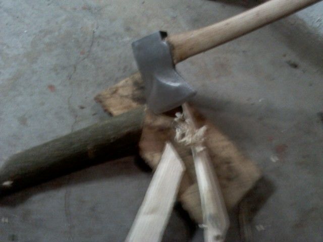

I just began working on my axes yesterday.

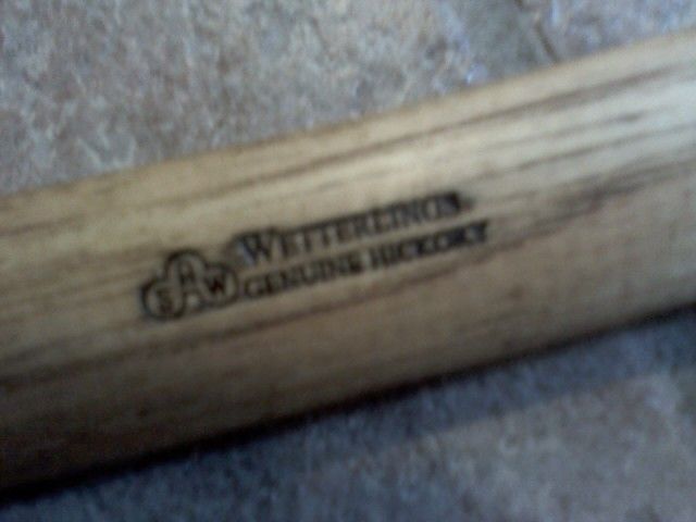

Basically, I lightly sanded the Boy's Axe and the Wetterlings and laid on a couple of coats of Danish Oil to darken the wood up a bit. I'm sure I'll go even darker than that, but I think they look a little better than stock for now and I certainly have a much thicker coating of protection than what they came with stock.

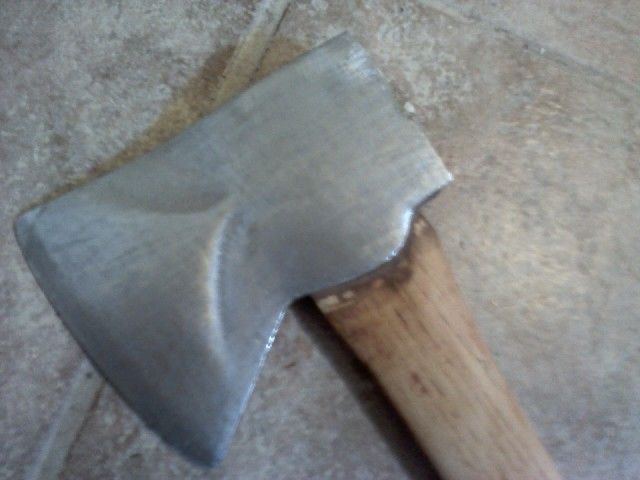

Now, the Plumb 3.5# ax was the bad-boy that gave me the problems. It didn't just bite me, but it damn near took a sizeable chunk out of my thumb. As I was passing a file over the edge, I slipped and ran my thumb into it. It cut clear "into" the digit between the nail and the outer left side of my right side thumb. It went "in" at least 3/4's of an inch, but me having a lot of experience with on-the-job wounds, I treated it right away and it didn't require stitches. The one I began working on is the red-handled ax in the OP.
I have to thank those of you who suggested going with an older ax. I notice the quality of the steel is so much better than the new cheaper axes I've had. As I worked to remove the coating on it, I couldn't seem to get it perfectly smooth, but I like the variations in the steel. Either way, the edge was razor sharp within a minute or two of passes of the bastard file I used. I like that. I even feathersticked with it a little. At 3.5#, it's a beast to handle, but like any heavy tool, you do most of the work lifting it and just guide it as you drive it down and let the head do most of the work. I've barely just begun to strip it, but as you can see, it's looking better than when I pulled it out of that barrel in the thrift shop. I think it's going to be really nice when I've oiled up the head and laid a nice rich dark stain on the handle.
I'm pretty sure that the Boy's Axe is going to be my favorite for any work while I'll keep the feller ax for the future. The Wetterlings has turned out to be a really nice tool for crafting and carving. I'm glad I stuck with it. I'd love to get my hands on an American made ax around it's size and with a similar head design. In fact, I may be having one handforged just for me out of some vintage American high carbon steel.
