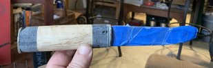

Thanks for the comments. Started another one last night and this is during the grinding process. This one is Curly Birch with Buffalo Horn. I’ll post a new picture once I’m done with the grinding and have a couple coats of TruOil on there.
The blade matches the height of the grip now.

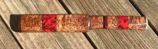

I agree the red is maybe overkill but I don’t make these to sell, I make them for the 8-10 hours of peace and tranquility they bring me while I’m down in the basement. I’ve been knocking out 2-3 month for years. Never thought they were good enough to sell.2039EB48-C343-4B45-886B-6F251FEA4740.jpeg1C74DB76-BBB0-4E41-8A30-90B88157B12B.jpeg

Your handle work looks very good, one recommendation I would give is to spend a little time fitting the bottom of the ricasso and tang to seat flat on the bolster, I can see very visible gaps between the bolster and the bottom of the shoulder. I really like the handle on your newest knife. It’s got some contrast going but still classy and subtle imo.
The one with a red handle looks fantastic. The one with the black handle looks like it doesn't have a perfect fit but otherwise that one also looks good.
I would have maybe gone with just one red spacer on the other knife but that's just my personal preference.
