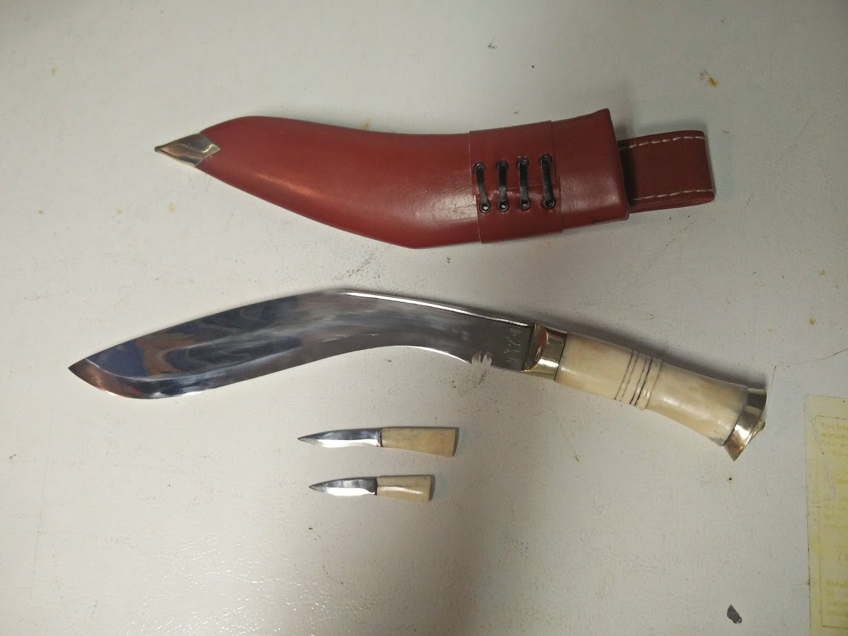

Hello there,
I am super new to these type of blades and am intimidated to use it, because then id have to sharpen it!
Which of the smaller blades is which? Both came insanely dull, so i am not sure which is supposed to be a smaller knife, and which is the field sharpener.

So one of your utility steels is a knife, correct, the other will have completely square edges and that is the steel.
A puck, file, sharpener aren't right - the ideal method is an assortment of wet-dry sandpaper 220,320,400,600 are my favorites but I would be comfortable with something like 220/320 and 600. Get one of the thick rubber ''old type'' mousepads, not the new,thin optical ones...
Then you draw the blade backward spine towards you over the sandpaper. Hold the spine up in the air so the edge contacts it at a steeper angle than you'd expect - you can find the angle by tilting it on your fingernail until it bites... You're trying to shape the edge like a bullet (convex) not like a wedge with flat sides. It may 'feel' less sharp but it'll cut great when you get it right. Covering the very edge of the blade in sharpie helps you see where you are removing metal! Good luck, don't be scared, get after it! A leather strop would have the same effect. a quick google of ''mousepad sharpen convex'' should get you a helpful tutorial or youtube video!

It almost looks in the picture like you got two Karda's. (the small utility knife). A Chakma is square on both sides, no attempt to sharpen it at all.
Other than that these guys got it right near as I can tell.

Ok then, it seems i got two Karda's then. Whew, it was driving me nuts trying to figure out what was what! Both have slight edges so i figure i should probably buy a Chakma.

Everyone seems to have this covered, but I will add that 2 kardas is not a bad thing! Some people sharpen their chakmaks too. You can always use the spine as a steel, and then if you lose one in the woods, you always have a backup
