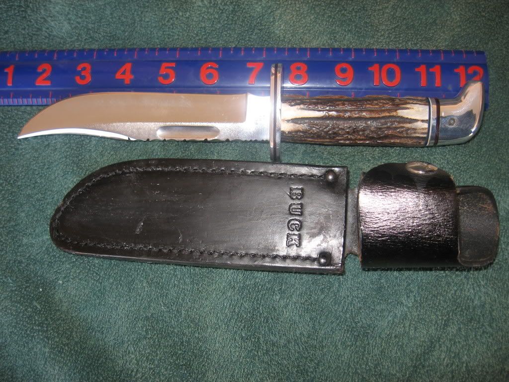

I have a buck special that was used and abused (by a younger edge13 unfortunately). The phenolic handles have some chips and gouges in it. I was wondering if anyone has ever rehandled one? Is it even possibe? If so how do you do it? Far left knife...cannot see the damage in the pic
[/IMG]
Many times,but never easily.Push the pin out of the pommel,pommel will slip right off sometimes,bust the phenolic handle off with a hammer.(fun part)Slip on the handle material of your choice,fill the void with your choice of sticky stuff,repin the pommel.Sounds easy,right?You can sand out a lot of scratches and gouges on your 119,you might try that first.Sometimes these rehandle easily,but usually there's a snag.Good luck,Don
