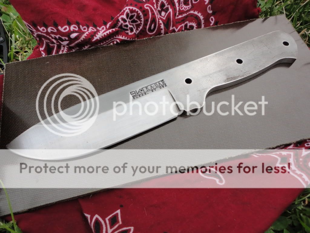

What size are the holes in the tang of a gen1 BK2?
Ive got some micarta for mine thats gettin pins and epoxy.

they are all 3/16 regardless of generation. That goes for all of the full sized Becker's, KA BAR or Camillus. Got's me a slab of Micarta that looks just like that. That'd be a cool project. Could you keep updating with pictures? Please.

hole spacing has been consistent for 30 years too. handle profile has changed slightly, so the very old machaxes with estalocs can't get micarta to be a perfect fit, it's close. pretty much everything else is spot on.
now, if KaBar would stop changing screw types around, even that would be easy peasy. as it is, a simple fix by buying your own high quality fasteners.
