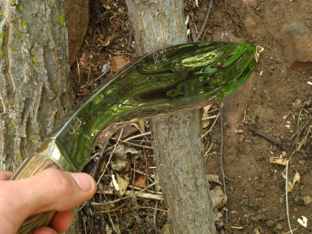

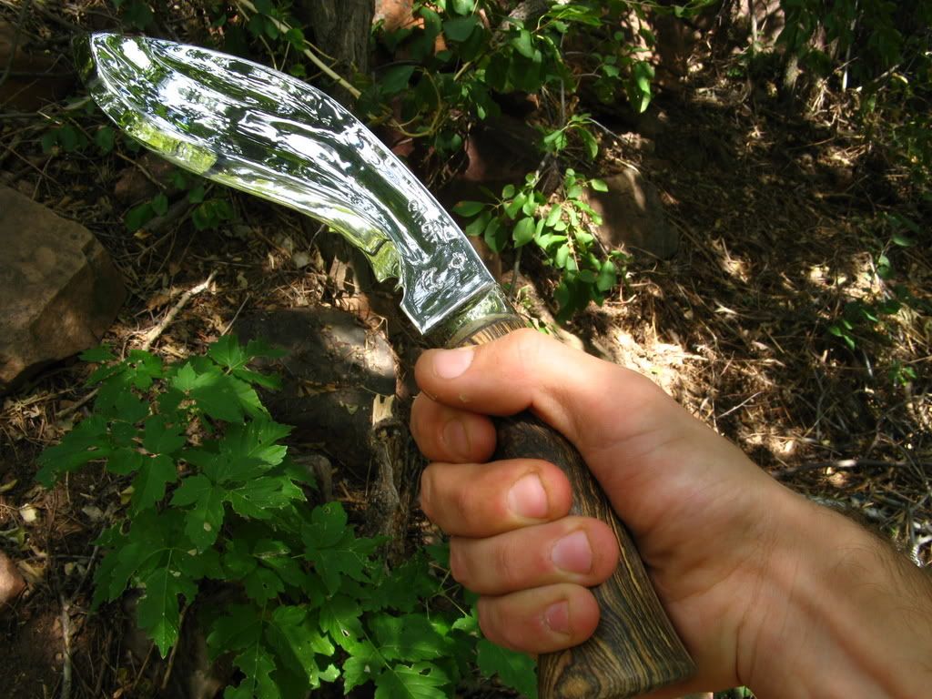

I got this 14" BDC on Thursday. The horn handles had to go. I picked out a good piece of bocote and finished it up today.
This is my first HI Khukri, and not my last. I have a Karda, but that doesn't count. Also my second rehandle project.
New handle is much fatter.
This tree is about to meet its end.
Goodbye!

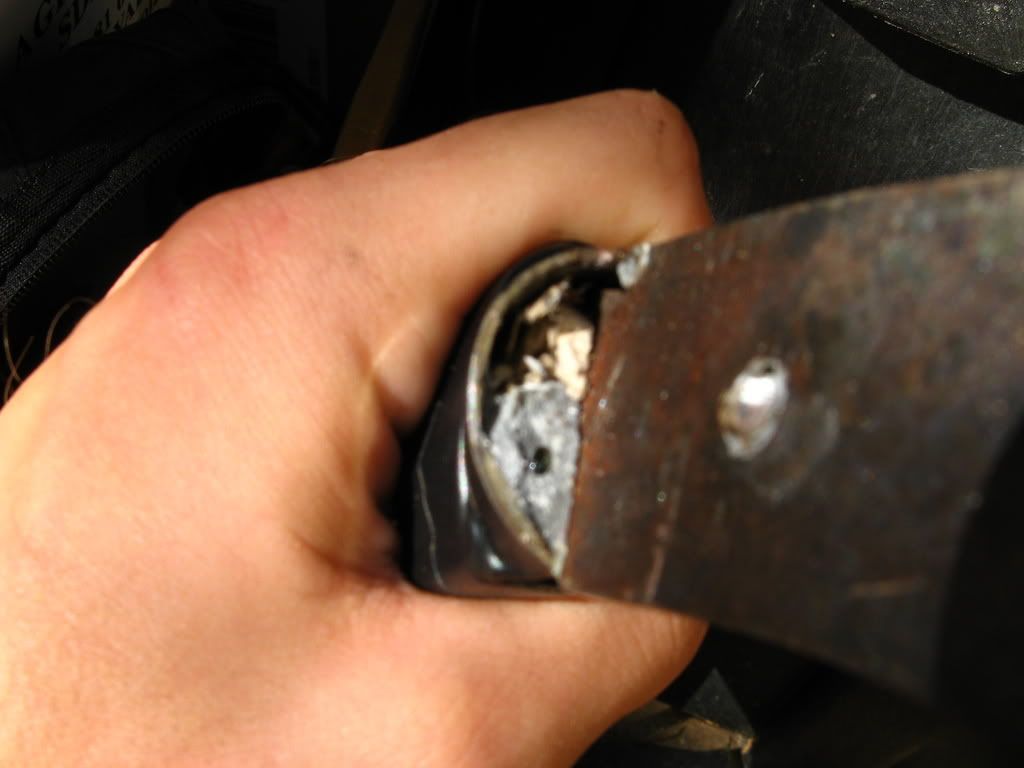

First I took off the old horn scales.
The bolsters were filled with epoxy and little bits of paper in the bottom. The paper was newspaper. From what I could make out they were scraps from the employment section. I hope the Kamis were not looking for other jobs!

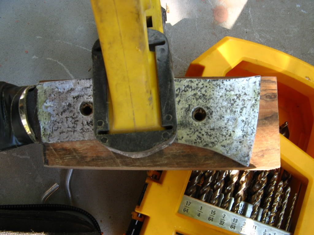

Chose the best piece for the scales.
Got the scales cut to size.
Drilled out the pin holes.
Made sure everything lined up.
I made some little pieces from scrap to fit in the bolsters.
Now we wait!!! :imp:
I mixed some sawdust with the epoxy to help the color match up. My biggest concern is the bolsters because they didn't quite line up perfectly. I put in plenty of epoxy so I shouldn't have any gaps. The pins are pretty ghetto. The originals were really soft and bent when I took off the scales. The tang holes were larger than the pins. I went with some old aluminum tent stakes for the pins.
Now once everything dries I can finish it up tomorrow!!

Question: how did you get the old scales off the rivet/pins? Did you drill out one side of the pins or break the scales?
Aw Hell, that's beautiful!
Thanks for putting up the step-by-steps.
I cut a notch in the first scale and just broke it off. The pins were really soft, I cut them with a linesmans pliers. I was able to get a chisel between the tang and the scales and just pry them out.

Curious, why you didn't extend the scales into the bolster. I know it's a bunch more work.
ilbruche, that is very fine work. Thanks for the tutorial, too. Bocote sure is a beautiful wood, isn't it?
Exactly. Too much work for me!
Since the bolsters originally just had some paper scraps and laha in them I figured putting the little bocote pieces in there would be better than nothing.
Maybe if I had more patience or experience I'd do it that way.

Beautiful handle, great work
I saw the step by step, but don't recall seeing the finished handle before... NICE!
And how shiny can that blade get? Did Jai Renaissance Wax it up prior to parting with it?
