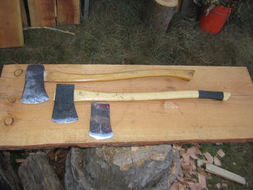

The original handle likely would have looked like the handle on the top axe in this photo.
That's a vintage Craftsman boy's axe with it's original handle. On the old handles the fawns foot was left pointed. Now they come sawn off flat like the 2nd axe. Note the 2nd axe has a smaller sized fawns foot. That's why it needed the friction tape - to keep the thing in hand. I like the vintage handle much better.
Thanks Square - the Fawn's foot on the handle I have from it, linked in the OP has a large Fawns foot.
