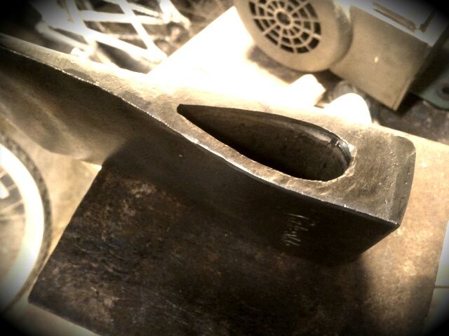

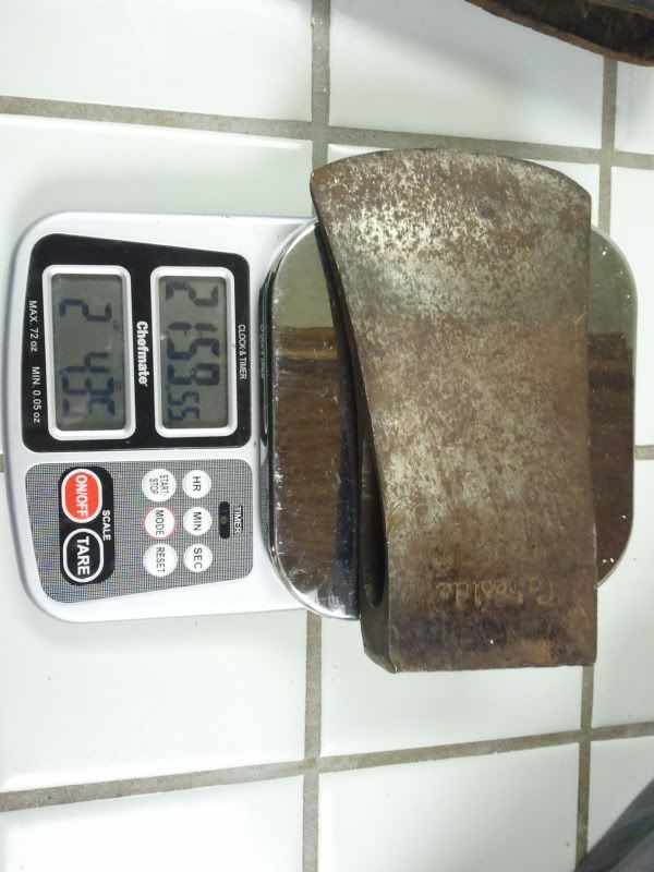

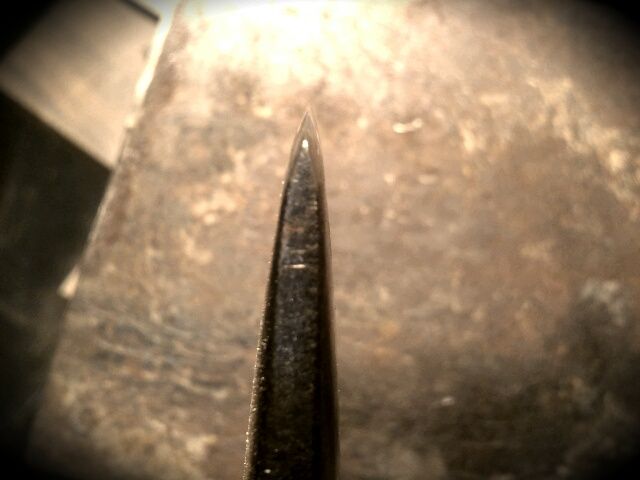

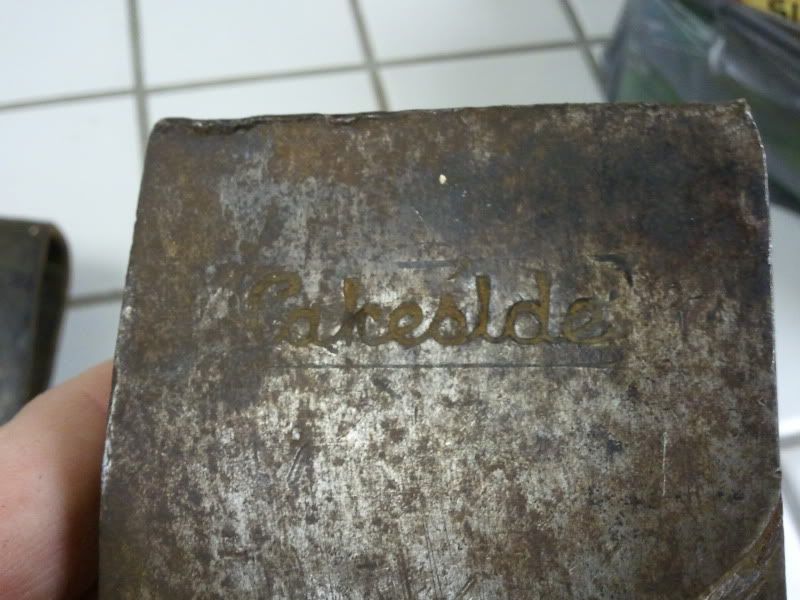

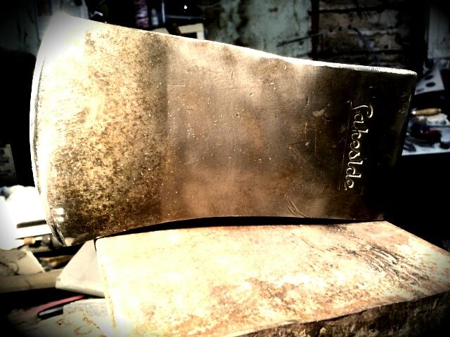

I thought it would be interesting to see some of the relabeled or house branded axes. Brands that were not made by the name on the axe, like Craftsman is made by Vaughn, to see what is out there. I am working on a Lakeside boys axe, which was a Montgomery Wards brand used up to the 1950's. I don't know who actually made it, but I know Wards did not.
Here is my Lakeside...
After some filing, wire wheel treatment and reshaped the eye...(photos styled in homage to Cooperhill's great looking photo style!)
