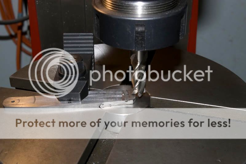

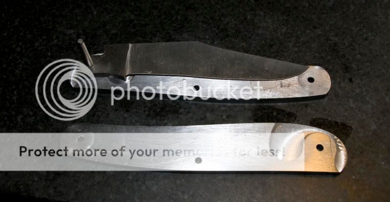

I use a rotary table , (because I had one) that has a center 3/32 pin. I use different size end mills depending on the pattern and blade. I normally use a 1/2 cutter or 7/16" In the bottom photo, top knife you can see were the exposed when open portion of the tang is protected from scratches when closed. I use a 4 flute cutter and normally will mill to a dept of .008. slow even feed, makes for less clean up in the relief.

No secret to this method at all! Just do not move your x y axis on the table once you do the first side. Just clamp the second side liner on, does not matter were as long as its on the center pin. The cuts will match perfect. One issue could be the center pin on the rotary table. I made a spacer and center pin for this rotary table. Most rotary tables have the t slots that meet in the center so this spacer and pin is a must. I turned mine on my lathe and was certain that it runs on true center of the rotary table. I might also add that both side liners have to be mirror images of each other for this to work. In other words if the side profile of one side was much wider than the other, it would appear as if the exit point was different, however both reliefs would be the same size, and same distance from the center , or blade pivot hole.

Hope I was some help. I had made a few milling in the reliefs going with the square method and I must say, in my opinion, that milling them rotary gives the knife a much cleaner, higher end look.
