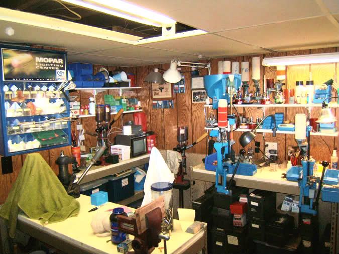

I agree with Mike L., hard to beat the Dillon. Yes it is more expensive initially than a single stage press but starting with a better press will let you shoot more with less time spent at the reloading bench. Buy the SDB caliber conversion kit for the second caliber and you will be ready to go.
As you can see I do like the Dillon products but out of sight is a Lee Turret and you can see an old Hollywood on the small table used for sizing rifle brass.
