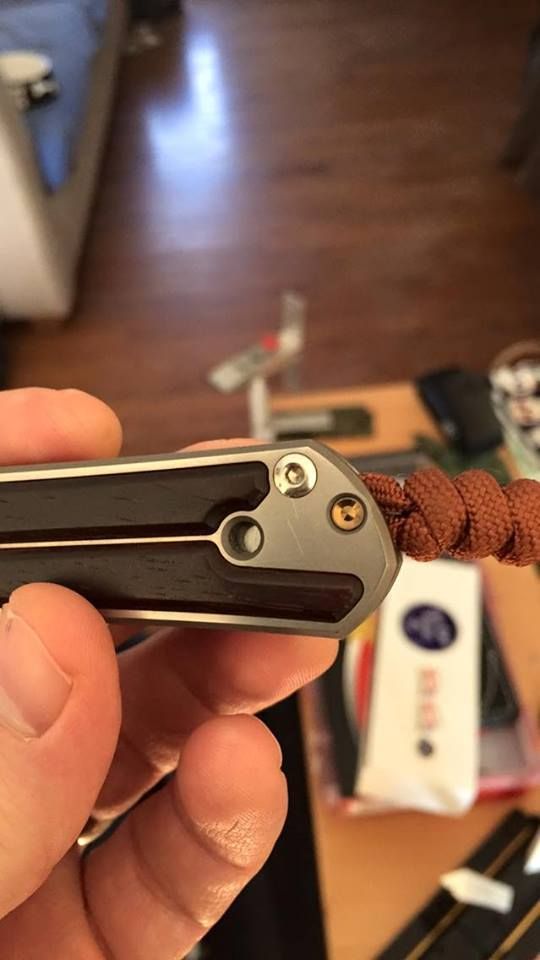

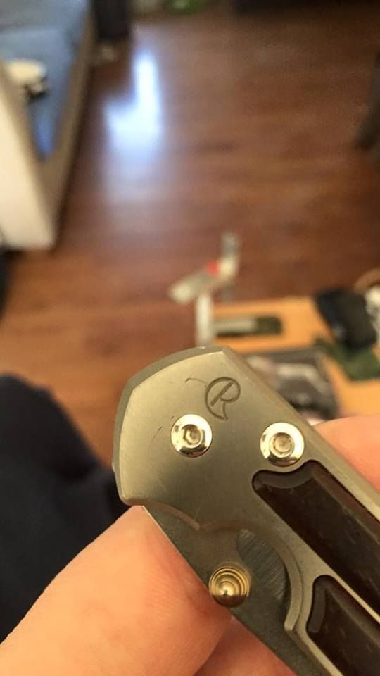

I just bought this small Cocobolo, and it was disclosed that it has some deep scratches on the scales.
I don't think these can be buffed or polished out, can they?
I don't really expect to be able to get it back to new condition, but it would be nice if they were a little less noticeable.
I don't care too much about them because it'll be a user, just wondering if anyone's had luck with removing deep scratches.

If you find an abrasive pad etc that has the right grit size and you rub it with the grain you can probably get most of it out. If you took the inlays out you could get it back to mint even with a slightly different grain if you couldn't match the original. If you did the back as well, it would be pretty much impossible to tell.
Here is my advice for what it's worth.
Use it as is. Anything you do to it will highlight the area even more. If you can get the inlays out and lap it (sand it on a flat surface) enough to remove the scratch, you will also take some depth from the CR engraving, which will look odd.
Sanding a little patch will reflect light differently as the scratch pattern won't be the same.

Actually, I received it this afternoon in the mail and was surprised that the scratches aren't nearly as deep as they appear in the pics.
I think I'm going to go with AJack60's suggestion and check with a local jeweler.

Just called CRK, they will re-polish the scales, but only on a case by case basis.
They have to remove the inlays to polish the scales, and I'd have to purchase a new set of inlays.
Mine are Cocobolo, which I think she said would be $125. I'd guess that's probably the lower end of the wood inlay spectrum.
I also asked if attempting to polish it myself would void the warranty and she said that it more than likely would if I took off too much material.
We agreed that I'd rather just have a Sebenza with a few scratches than either of the above alternatives.
