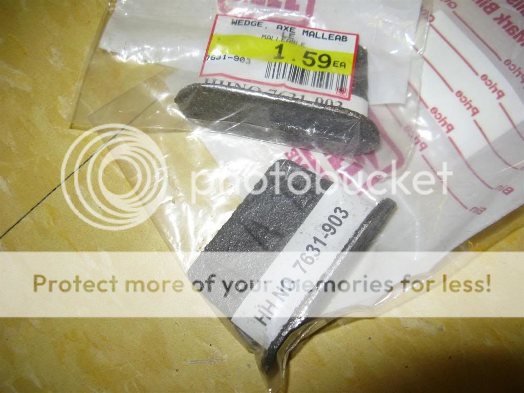

A few months ago on thread "it followed me home" a picture of a vintage axe with a metal exposed-head wedge was posted. There was some puzzlement and debate about these and not long after I discovered that these type of wedges still exist. Here is a shot of a couple from the axe shelf at a Home Hardware store in Cambridge. Ontario. Country of origin and manufacturer cannot be discerned.
The singular advantage of these is that the installed wedge has a flanged head which allows for relatively easy removal.
Very few axe users are purists who deliberately remove a loose handle in order to replace a wood wedge. The majority of folks merely drive in conventional steel wedges or multiple nails/screws and what-have-you until the axe head is usable again. These temporary wedges (that's what I'd like to think they're for) do not relegate an otherwise perfectly good handle to the scrap bin should an urgent or emergency fix have to be done in the field.
Found these are made by garant on home hardware website. Interesting history of garant on garants website.

These items are listed (2 sizes even) on the Garant website. I dunno whether Home Hardware (a uniquely Ontario-based small hardware store chain) who carries them, or Garant who supplies, will ship these to the States. Now should you be passing through Cambridge Ontario and find the Home Hardware store there (on Hwy 8) likely as not there are still some there on the shelf. And while you're there grab a couple of top drawer locally-made axe handles! Haven't come across decent handles in the Ottawa area (300 miles NE of Cambridge) for almost 20 years!
Cool that they're still being made, but it'd be perhaps surprisingly difficult to remove the wedge thanks to the pebbly nature of the low quality casting.

Snowy day yesterday so the local hardware store was quiet. Perused all the new axes (made in China and in Mexico) and replacement hafts. Pictured are packaged versions of capped metal (aluminum) wedges. Notice the difference in prices despite the items seemingly to be identical. I am of the presumption that if you don't drive these in flush that they are easily removable with a claw hammer or in a vise.
A loose head in the field is bad luck and by temporarily installing one you can safely finish your work and still be able to reuse the haft via a new wood wedge. Metal wedge likely will compress wood fibers somewhat too so that when withdrawn the haft will be that much easier to pull free.

It looks like the window cut into them would aid in removal.
Noticed that too. By my thinking the 'window' is a faux pas for strength, and the wedges should have been made of steel; aluminum is soft/brittle and not forgiving and could break while being pounded in and/or being pried out. Aside from that I sure like the concept.
