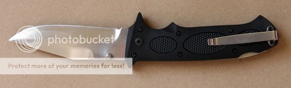

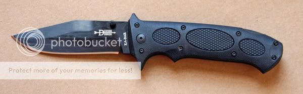

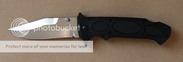

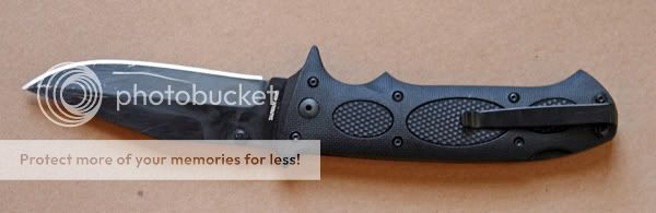

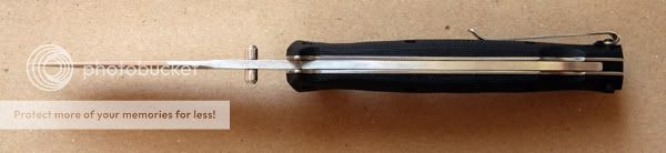

I trashed the (soft!) black coating on my Ka-Bar Dozier Bobcat. Love the knife - hate the weak coating. Since I was taking it apart anyway to clean it, I decided to strip the blade, liners, and clip. Pictures coming up as soon as I can get them polished up.
How did you do it on the Kabar ? With chemicals (stripper of some type ?) , or sanding,etc
I'd like to get an Orange Dozier with the original blade,to my knowledge these are only out in the black :barf:
TIA
-Vince
I got some heavy duty stripper in an aerosol can. Sprayed it and let it sit - then took a Scotchbrite pad to it. Worked pretty well - kinda regretted starting it on the clip, though - hard to get into that thing and get all the black off.
Here are my photos of my Bobcat. First - the soft black coating after a few hours of use:
And after stripping the blade, lock bar, liners, and clip (wish I hadn't tried the clip - what a pain in the rear - there is still some black on it if you look closely). Some of the marks are fingerprints. Some (in fairness) may have come from inadequate polishing - I refused to spend more than two evenings on this:
