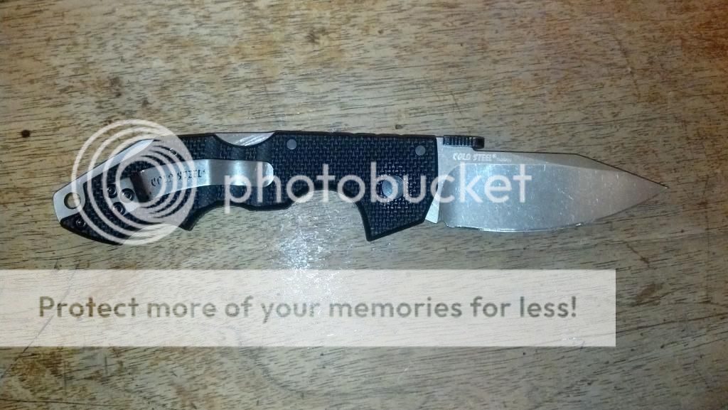

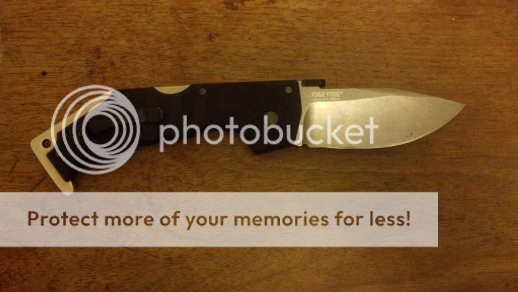

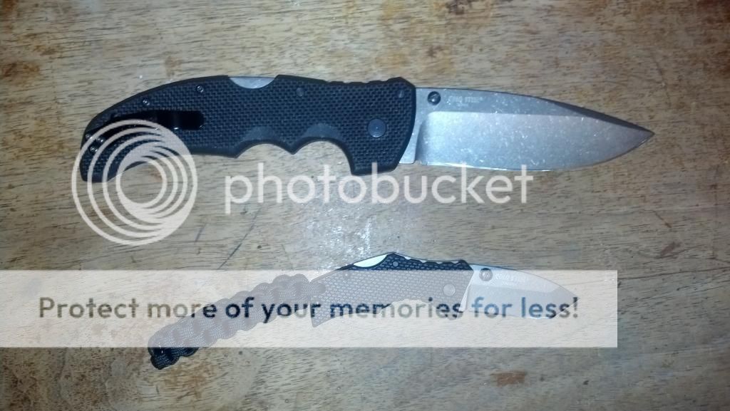

i have stripped cold steel recon 1 and ak-47 series with a knife, other knives may be stripped with paint stripper, it is easy and the stonewashed blade looks so pretty,
zt/ kershaw dlc is hard to remove, if you want to remove it, you have to sand it and polish to a mirror finish and it is a pain to do

i stripped the blade and the lever lock, for ak-47 pommel, it was anodized so i sanded it off and buff with dremel buffer kit
also i have modded my cs ak-47
and mini ak-47
and recon 1/ micro recon 1
i think im going to do this on my ak-47 because i have been having lock issues with it. maybe the lack of a coating will solve my issue
remove the lock lever with razor and put a 800 grit sandpaper on table and sand the lever flat, that will correct any bumps then go up to 2000 grit and add a film of oil. i did that and i had no issue and it is so much smoother and easier to unlock it
