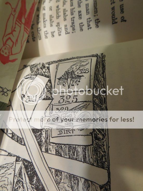

I will second the above comments about drilling and drifting the old handle out but just to be thorough, here's Dan Beards take on it from the Book of Camp Lore and Woodcraft:
