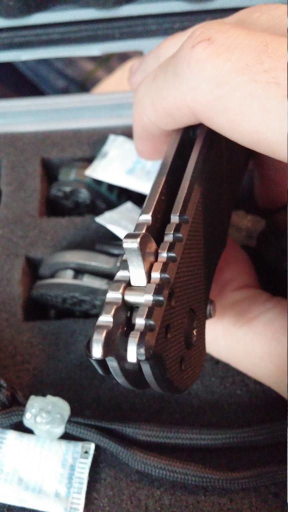

Just got my 0566 in and it's a cool blade but I'm not much of a flipper guy and want to grind it off, was just wondering if any if you guys have done it and could give me some tips as to how to do it, or maybe do it for me
Other than "don't do it"? The flipper is what keeps the edge from smacking into the standoffs. Very small margin for error.

I would say, "NOOOOOOOOO!!!!" I love mine! Thanks uxo2. But if you were to do it , I would say use a dremel cut off wheel and then sand it smooth

Have you used the thumb studs much. I found it difficult until I de-assisted the knife. This knife is designed to use the flipper. Others have removed it and de-assisted as well and are quite pleased. I lightened my knife and removed the spring.

Some have used dremels and others bench grinders. You want to keep it cool. Lay out the area to be removed then remove the blade. Place tape on the blade to protect you and the blade. Clamp in a vise when using a hand tool. Take your time and don't do it if you are tired.
