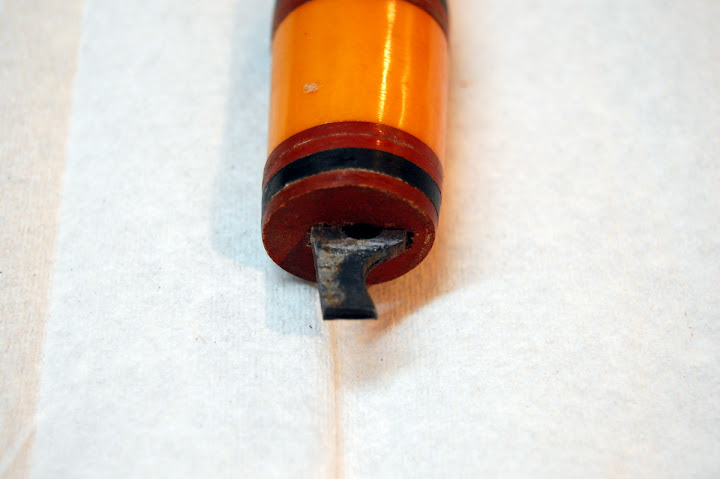

The stacked leather handled knife is a 9" Stromeng carbon steel blade from ragnar.
Here are two Bruselettos that I bought from ragnar and finished myself.
Just cuz they're scandi blades doesn't mean you have to make scandi knives out of them :D
I put these up hoping to get across how much fun you can have with a drill, some files and a bunch of sandpaper.

There's a brass tube rivet at the rear of the handle, That's all that holds the kraton on. Drill out the rivet, wrap the blade heavily in tape, clamp in a vise and pull the handle off. It may take a litte persuasion with a rubber malet. You will need a block of micarta instead of scales, and you will drill a pair of parallel holes lengthwise through the block. Use round files to make the 2 holes into one oval hole. You will need to make a guard, aluminum, brass, nickle, steel, contrasting micarta can be used. There are tutorials in the makers forums on how to do it. Hidden tang knives are the easiest knives to do a handle for the beginer. They require the least amount of specialized tools. A hand drill, a long drill bit, some small drill bits, a few files and a hack saw to cut guard material and sandpaper.

It's that piece of flared tubing in the hole at the back of the handle. The tang will be hardened like the rest of the blade. You can drill it with a carbide drill, (must use drill press)
Tube rivet http://s1200.photobucket.com/albums/bb340/uncleelbow/?action=view&current=coldsteeloda.jpg
