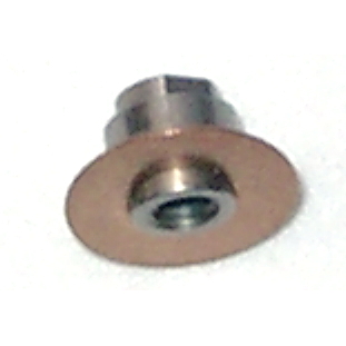

You have to be careful replacing the pivot barrel in the Para2. One side has a flat spot (a "D" connector) that needs to be lined up in the correct orientation in the correct hole of the correct liner. In other words, there is only ONE CORRECT WAY to reinstall a Para2 pivot. I know you guys know this, but I've seen folks get a bad fit during their reassembly - which can lead to the blade binding.
You can kind of see the D-connector on far side of the pivot below...

Look at the hole where the pivot goes through. On one of mine it had a nasty burr that wasn't cleaned up in assembly. I used my dremel with a soft grinding bit to remove the burr and everything became silky smooth after that.
I had the same issue. The burr was on the flattened edge of the pivot hole in the liner opposite the lock, and opposite the side my blade leaned too. Looked like a punch was used the make the hole and it spun or got stuck on extraction and pulled the burr up with it. It was slightly digging into the bronze washer slowing the action and surely throwing it off- center a bit. I cleaned up the burr on the flat side of the liner and cleaned up the washers with a fine ceramic stone. It works beyond belief now. Its amazing how freely it rotates with the lock depressed. It swings like a pendulum when I press the lock to drop close it. No blade play and blade sits dead center. Took me a while to find the sweet spot though. I dug out loctite a couple times before perfecting it. I've only had it 3 weeks now and it feels like an extension of my own hand. Like its always been there. I love it. I still find myself worrying if this will mess up in the future and that I should have sent it in before voiding my warranty. Partly because I couldn't completely straighten the edge on the inner part because I was afraid of the inside diameter of the hole getting too large. For now it works like a charm
