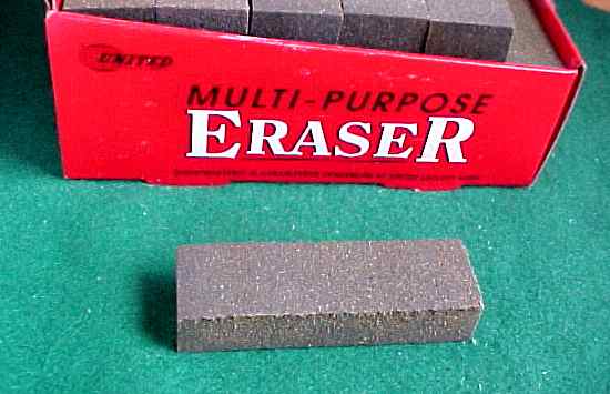

I used to use these:
With a little elbow grease, they took the thick-ass coating off of my Emerson Raven and left a nice satin finish behind.
