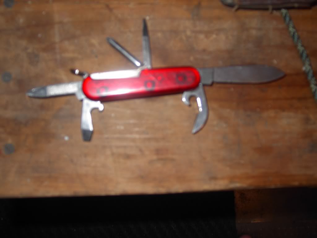

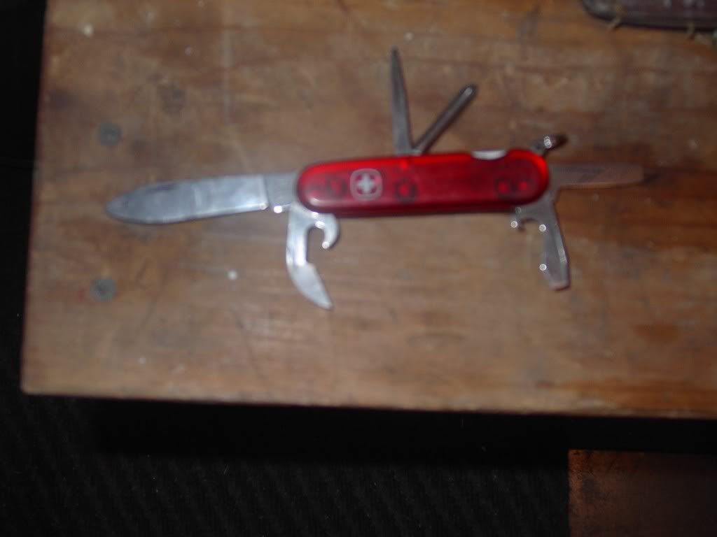

I want to remove the scales off this wenger, but I do want want to break them while getting them off. How should I appoarch this and wat steps do I need to take. Sorry for horrible pics.

All you have to do is stick a razor blade or something very thin and metal between the scale and liner and twist whatever lifting tool you are using to pop it off of each of the three rivets. On reassembly, if you're using the old scales again, you might want to put some adhesive in each of the rivet heads as the lip that holds the scale down will now be stripped or chewed a little.
