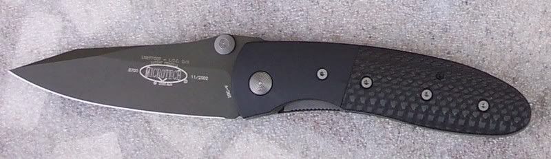

I recently removed the green coating from a MT LCC, by hand. My understanding (incredibly likely to be incorrect) is that paint removal type products would have little impact on “Ti ni” (or Boron oxide maybe) “coatings" so knowing what you are working with could be very useful.
Anyway, it wasn’t much fun and one has to be patient and use progressively finer sandpaper. I started with 320, then 600, then “very fine” steel wool, then 1500 sandpaper. I’ve always read that one should use waterproof sandpaper for this, so I did. It turned out pretty good but, as you pointed out Brian (number 6,244), finger grooves, screws etc… are especially challenging. To make it slightly less so, I took the LCC apart (its own small challenge) including removing the thumbstuds, all of which voids the useless MT warranty. Many manufacturers use loctite to make sure essential components don’t loosen up, so you might wish to communicate directly with someone who has disassemble your model to find out any such nuances.
I had to keep reminding myself that I bought this particular LCC to be a user, otherwise I would still be at it, working on this or that speck that lacks perfection. I’m glad I did it, and I would consider doing so again but would probably be more aggressive initially with the 320. I also found it worthwhile to work back and forth at times reverting from finer, to courser sandpaper. I also agree with Wapiti that using a bench grinder can create its own peril. I suppose if you are used to it, slightly less so, but I wouldn’t want this to be one of my first bench grinder projects. You are likely to need to reprofile the blade after all that sanding.

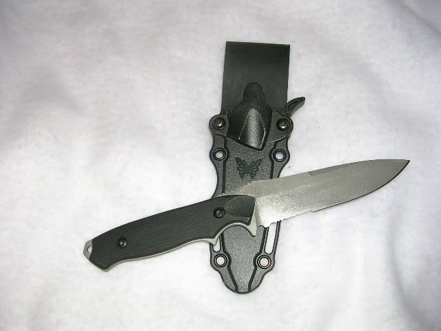

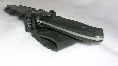

I removed the black coating from my 806. That was the easy part, getting the surface to have a nice looking finish was difficult.
The thing is that the metal under the coating is left rough. The reason, from what I have heard, is to improve the adhesion of the coating to the metal, but it could also just be that since it is going to be coated anyway there is no need to put a nice looking finish on the metal because it will be hidden.
Either way, this just gives me an excuse to show my shiney bladed 806.

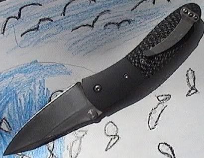

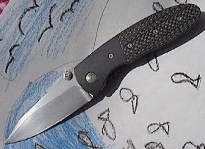

Mine started out like this (with respect for the Badguy, who can actually take a decent picture):
Then went to this:
And now is here (for awhile, anyway):
The MT logo is still faintly visible on the blade, as are the other markings. I really chewed up the thumbstud trying to get it off (combination of locktite and wrong tools for the job), but finally did. Were I to do any more work on this one, I would feel obligated to change it out.

A bit more than that, but for the most part the coating came off with the buffer. It was the old BT2 coating though.
