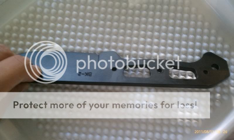

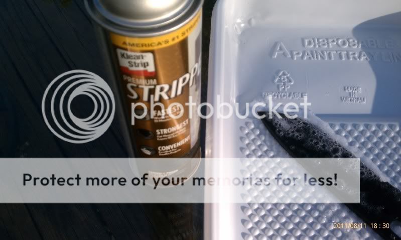

I did a BK2 a while ago. I hate the black coating and I decided I would take care of the knife instead of dealing with the black. Went to Home Depot and bought some stripper.
After a while it just bubbled up and I could scrap it off with a plastic knife.

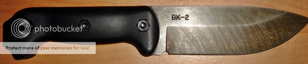

From there the knife is exposed. This particular BK2 I did some mods too and sold so I have no report on the rust issue. Here was the final product.

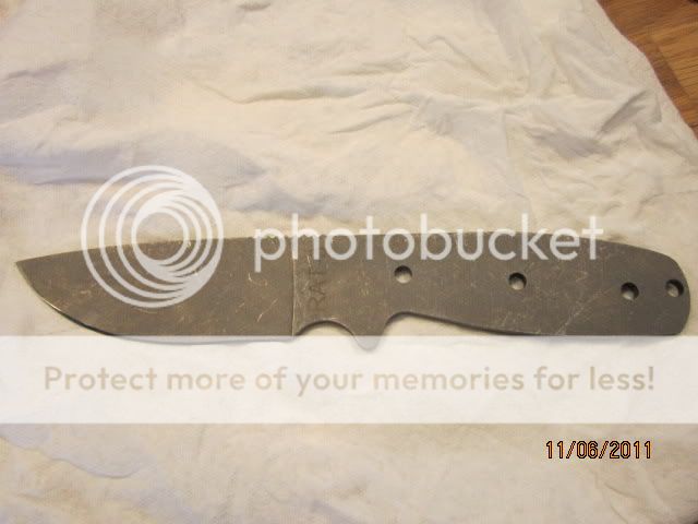

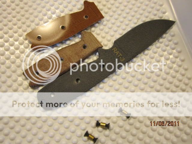

All that said, I bought a RAT-3 not long after and did the same thing.
Same stripper. After everything is off.
After homemade stone wash and PCB etch.
I ended up coating the blade and micarta with boiled linseed oil. Several months later living in Baltimore (the rust belt) not a single bit of rust.
Keep it clean after each use. Don't be lazy about it. Try a finish wipe of oil to help preserve everything.

If you want fast and clean results, get some paint stripper as seen above.

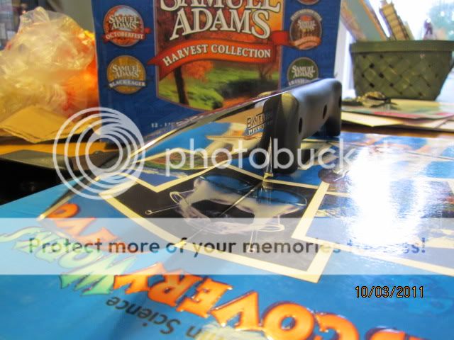

The benefits out-weigh the risks as long as you don't live in the wet lands like me. This is not always the case, bringing your knife up to the mirror finish like willydigger did will help prevent rust because there are smaller and few places for water to take hold. Other solutions include duracoating, patinas, and etching.
I used a dremel, a drill press with sanding drums, hand sanding and a buffer wheel.
Then I applied a mustard patina, then hit the while thing with vinegar. I left the paint on the handle because it offers better protection.
